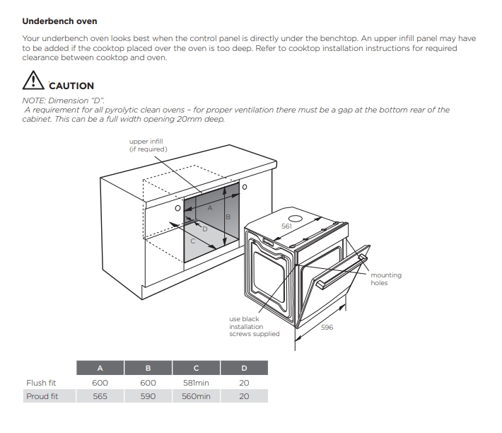

I wanted to buy Westinghouse Oven for a kaboodle oven cabinet- WVEP6716DD … after looking I believe this will fit in Proud into the kaboodle cabinet ??? It will stick out 21cms is so I’m guessing ??? Then I need buy an oven pack or some panels above and below to make it look more flush ??? Will it still have enough room to connect the wiring behind as it seems the oven then will be flush from behind to wall and normally I hope the ovens are slightly recessed for wiring harness?
