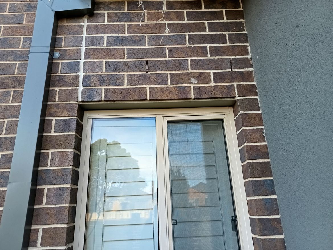

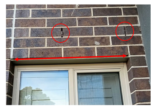

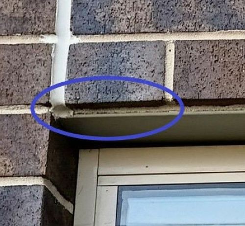

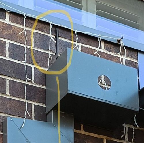

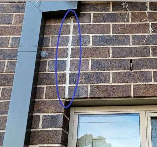

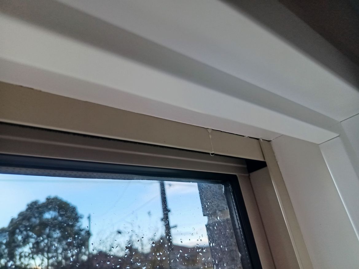

During the heavy rain yesterday, found water was dripping from the window frame inside the house. Only this window is leaking at two place at the top frame and it is a double glazed one. Any suggestions what is causing this leak and how to fix this? Has the window seal failed or the exterior of the window frame needs to be caulked.
