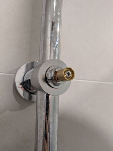

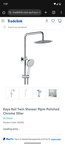

I have a twin shower head. I overturned the diverter and now it won't tighten again, just keeps spinning. Not sure if something has fallen off but I can't figure it out.
Hello @jordanperret
If you look closely at the handle there might be a hole from which you can see the grub screw. You'll need to use an Allen key to turn the grub screw to tighten the handle back onto the diverter. However, if you don't see a hole, odds are you'll need to remove the pin handle in order to access the grub screw. I suggest having a quick look at this discussion - Solved: How to install Estilo tap handle? by @Monty1089. The methods used are applicable to your diverter handle.
Thanks Eric. The Allen key was applicable but I found the screw thanks to you all sorted. Thanks 😊
