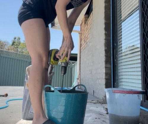

In a large bucket mix up mortar mix with water with an electric mixer attachment for the drill. Mix until you get a toothpaste consistency. If too wet add more mortar mix.

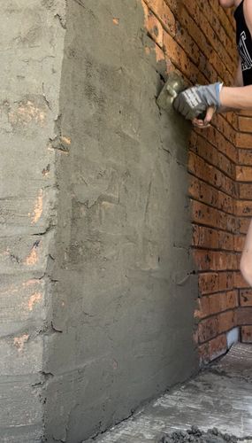

Working from the bottom up, using a trowel on a 45 degree angle push mortar into bricks as you sweep it up in a motion similar to a windscreen wiper.
Step 4

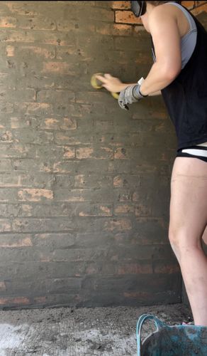

Once you have an even coat in the bricks, leave to set slightly. Depending on temperature this can be anywhere from 10mins to 40mins. Then with several large sponges and a bucket of clean water, use a damp sponge to wipe back the mortar and smooth it out to your desired finish.
Step 5
Wait a couple days and then with a stiff broom brush off any excess dust/mortar that might be present. Leave at least 30 days to set before painting.
