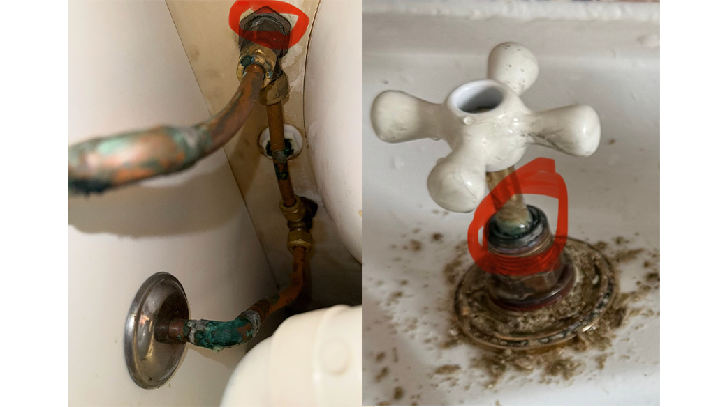

When the spindle turns on and the water starts flowing, the area circled in red in both pictures begins to leak. How to fix?
Hello @gab12345
Thank you for sharing your question about your basin tap handle. Please note that plumbing work needs to be completed by a licensed professional for safety and compliance.
If the leak is coming out from the top on the body of the spindle, odds are the body O rings are worn out and need to be replaced. I suggest looking at this guide - How to replace a tap washer. In step five you'll see the body O rings being replaced along with the tap washer. My best advice is to make sure that the O rings are fully lubricated before you reassemble the spindle. Failure to lubricate the O rings will tear them apart inside the spindle body.
