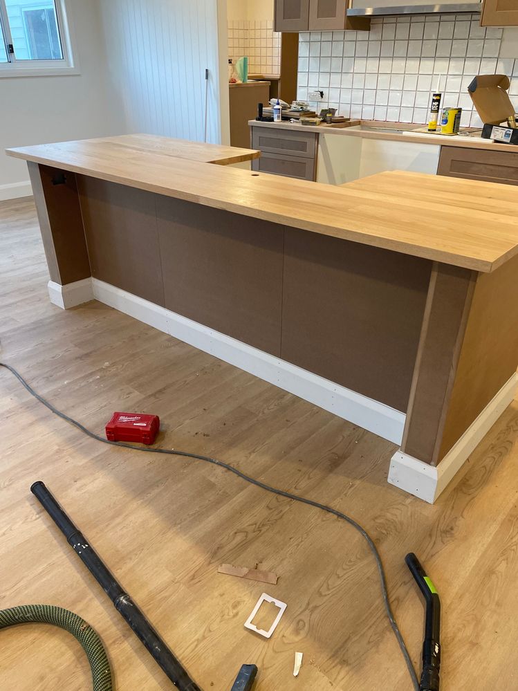

This project was a full DIY renovation of our kitchen, using the Bunnings Kaboodle raw board range. We wanted a space that felt more “us” warm, functional, and a bit more custom than your standard flat pack. We modified two 450mm drawer units to fit our butler sink by removing the internal compartments, and finished it off with a Kaboodle American Oak bench top for a natural, timeless look. We painted the cabinetry in Dulux Dark Sky, which brought the whole space to life with a deep, moody tone. It’s been equal parts challenge and reward.

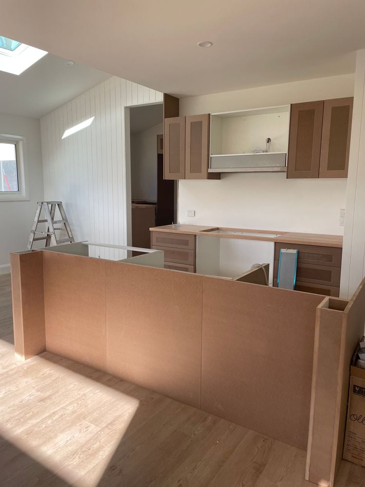

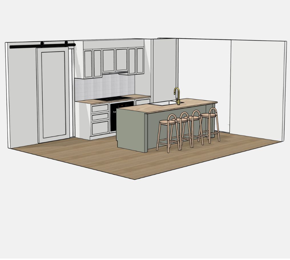

We measured our space and planned out on sketch up,. this helped us visualise how the cabinetry would fit.
Step 2

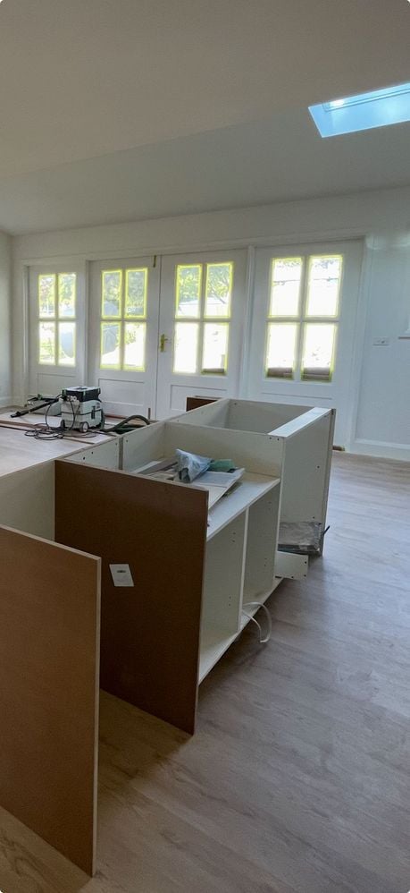

We got to work assembling the flat pack cabinets...
Step 3

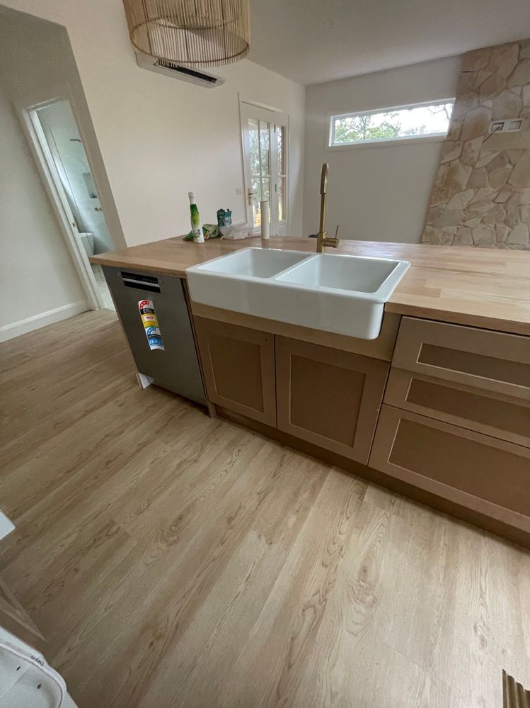

We modified are thing in our kitchen butlers and laundry .. one being two 459 drawer units for the butler sink.. we removed the drawer runners and inner frames and created one large open space that the 900 sink with sit into neatly.
Step 4
we cut and fired the bench top, then made the sink cut out using the jigsaw.. we then oiled the timber before stalling the sink..
Step 5
Stalin the butler sink. We carefully lowered butlers sink into the custom space..
Step 6

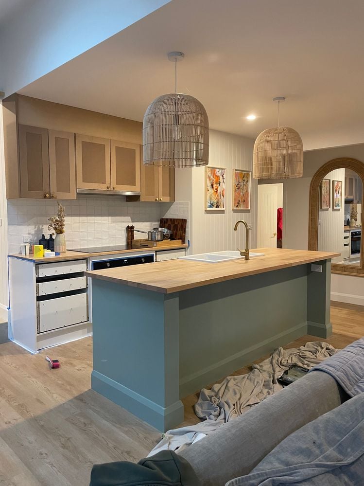

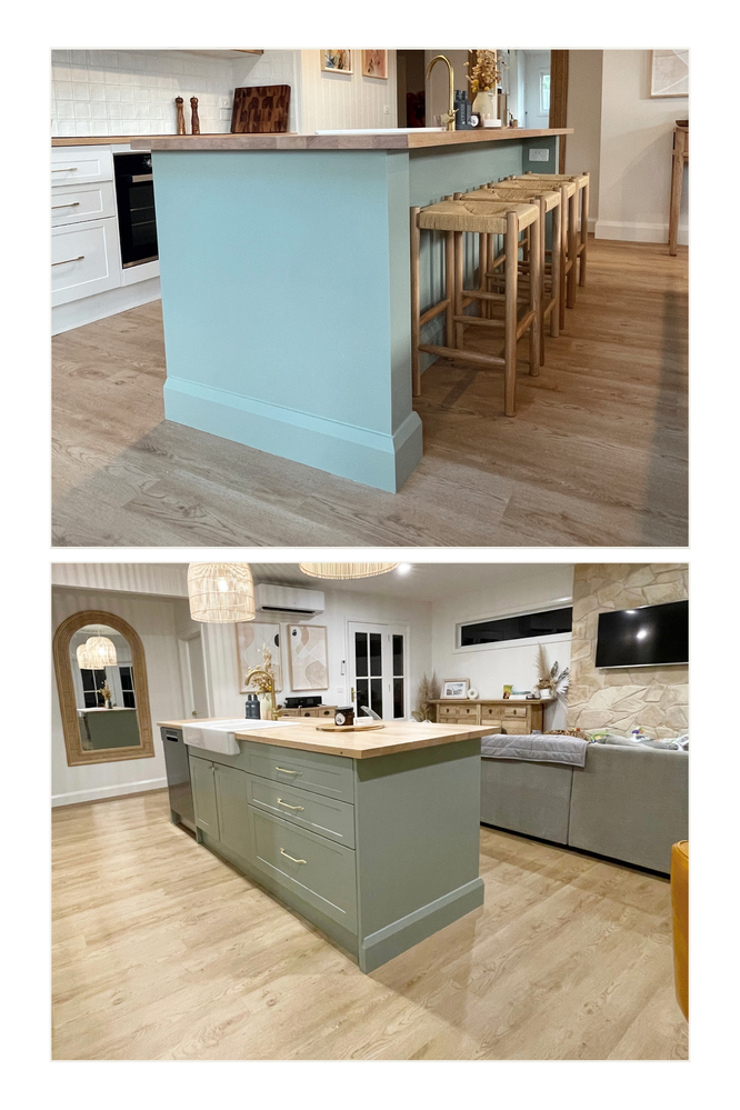

Painted the raw board fronts.. We gave the raw doors and draws a light sand, applied a primer, then two coated of dark sky by dulux ,, we used a roller for a smooth finished and light sanded between coats ..
