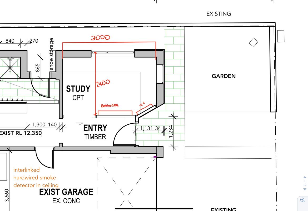

Hi Everyone
This is my first post. I am in the middle of a whole house renovation. It’s going well but as many of you would know the funds tend to evaporate before your eyes. I am building a study (man cave) at the front of the house for me to have my Mac and photography equipment setup. Unfortunately the budget wont allow for custom cabinetry so I am going to need to be innovate and hack some off the shelf items. I am fairly handy and have lots of tools so should be ok. The room is approximately 3m x 2.4m. One of the main features I am looking to make it a long desk the whole length of the room and a return. If anyone has done something similar before would love to see your project. I am going to need to source a 3 metre length of timber or laminate for the desktop. I would like it to have the appearance that its floating with minimal legs / supports visible. I will also need to join the 2 pieces of desktop. I am thinking dowell joints maybe but would need a jig to get the holes to line up. As the room is narrow the desk would probably be no more than 5-600mm wide. Behind the desk I am thinking wall mounted bookcases. Surprisingly these have been hard to find. The best I can see at the moment is the Eket range from Ikea which are not quite ideal as I was more after a traditional looking bookcase than cubes. I guess the other option could be to buy sheets of laminate and build them. It seems hard to source MDF in anything other than white. I am getting multiple GPOs and data point in the room so everything is networked. The floor will be blond southern beech timber. Any help with design or tips on construction would be much appreciated.
PlanElectrical PlanThis is what it currently looks likeStudy to the right of main entranceI like this sleek contemporary style

In regards to the floating effect for you desk, here's an install I did of a 2880mm laminate desk. The floating effect is pretty straight forward and will be even easier is fixing to timber frame.
I'd suggest doing your join perpendicular to your 3000mm wall, ie. you'll have a 2500mm length (assuming your width/depth is 500mm) and a 1900mm length with the angle cut for the portion of the wall with the TV. However you decide to do the join (dowel joints will be fine), put a heavy duty L bracket under it for support/strength. Fill any slight gap with colour-matched silicone.

Much appreciated. I did see your desk project. Nice job. The walls I am mounting to are brick / render so will be harder to hide the brackets. I could probably paint them the same colour as the wall. My electrician has put in some 32mm conduit in walls where we are running TVs. I have a lot of planning into the wiring of the house which I would recommend to anyone doing a big renovation. It’s so much easier to do it when the walls are apart than later.
You'll see from my install, I cut into the plaster/render to set the bracket then patched over it so you can't see it. Are you able to do this or are you installing on exposed brick?
No the brackets are going onto Render. I could probably chase into it with a grinder come to think of it. What do you suggest for spacing of the brackets.
Easy done with the grinder - it's worth the effort for the seamless/floating effect @JS001
I'd space roughly every 800mm given the size and weight and what you're planning to use it for - make sure you get the HD 6mm brackets. Sneak some smaller HD brackets like these in between to give the desk a good hold against the wall. I don't think I'm explaining that properly and how it helps with the hold - does it make sense to you?

Mate I am currently doing something very similar to Pete's example and just wanted to offer another possible option for fixing to the wall...however I will caveat that Pete's example is the KISS approach in terms of getting the floating effect AND ensuring that the shelf/desk is sufficiently 'load bearing' 😉
I am doing a similar 'floating desk/shlef' type of option in my WIR (shelves 1230mm long) and a recess in my dining room (1750mm long). The recess unit I haven't completely been through how I will do it...but with the WIR shelves I have a similar 'arrangement' in that they are an 'L' shape.
What I am doing is placing a 'ledger' (a horizontal piece of material) on the four parts of the L...or in Pete's case he would have three - without doing a drawing I hope that makes sense! - and simply fixing them to the wall (wall plugs and screws). The shelf goes on top of the ledgers, then a front piece of timber is put across the remaining two front sides of the 'L' shape. (in Pete's example there would be only the front one piece).

Thanks mate. My initial thinking was to actually fix a ledger to the 3 walls that the desk would sit on top. The only issue would be the strength at the front. Perhaps a combination of the ledger and some concealed brackets might work nicely. I dont plant on having too much weight. An IMac, scanner, printer although I would always over engineer to a point that you could place some heavy items on the desk or someone decides to sit on it. I have 3 kids so the possibilities are endless
A ledger definitely a good way to do it also @Former Workshop member. The pane I used is just a laminate benchtop, from my bathroom/kitchen supplier. I'm nto a huge fan of the laminate finish myself - this was done for a customer. I'm a timber, stone, concrete, steel kind of guy - I like the real/raw materials. Even all my furniture is solid timber (Oak) rather than veneer, etc.
@JS001 ledger + L brackets for load support sound slike a great way to go.
@JS001 wrote: Perhaps a combination of the ledger and some concealed brackets might work nicely. I dont plant on having too much weight. An IMac, scanner, printer although I would always over engineer to a point that you could place some heavy items on the desk or someone decides to sit on it. I have 3 kids so the possibilities are endless
Top stuff @JS001 mate; I love the way you are thinking in terms of 'real world situations' (might have three kids on it sort of thing). It is a great approach to ensuring that it is structurally sound *thumbsup* My apologies if my first response sounded a little like '1+1=2' as well; I certainly did not want to sound patronising! It is tough to tell from a single post how much experience people have with deisgning and constructing things...my apologies for that. You obviously have an idea what you are doing so rock and roll 😀
Definitely a combination of the brackets and ledgers would be more than suitable...I really don't want to chase into my walls for my recess area drawers so I am thinking of trying to use some 'Equal Angle' or something else...however I don't know if it will help at all but this is a link to the Bunnings backyard that had the floating seating that spanned a healthy distance:
