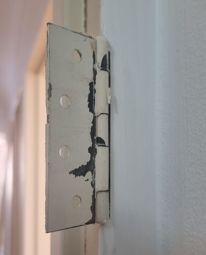

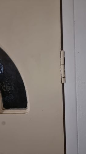

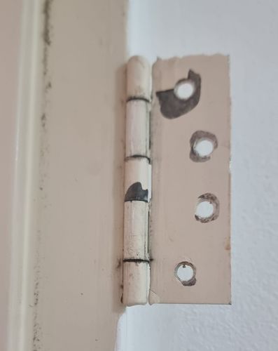

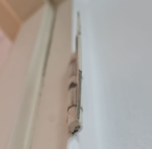

Heres the pictures of the hinges.
It looks like they are welded into the frame. When I tap on either side of the hinge then it just sounds like a hollow metal frame.

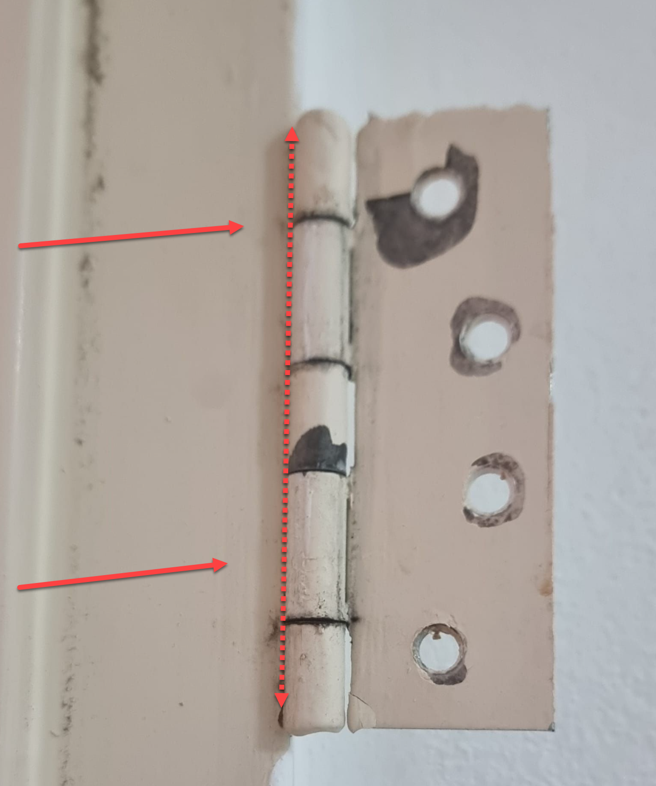

Thank you for the photos. Unfortunately, you've taken photos from about every angle except for the one that might give us 100% confirmation that they are welded. I am fairly confident they are, but if you could upload one more photo showing this seam here from the left side of the hinge. You should be able to see some tack welds on alternating sections that would confirm.
If it is welded, you can cut the hinge off with an angle grinder with a cut off disc. You can then use the hirline hinges I mentioned above.
If you wanted to reuse them, you could apply paint stripper, then use a paint scraper to remove the paint. Any leftover paint can be removed with some wet and dry sandpaper. Just make sure to wear a mask, gloves and open the windows to allow airflow as paint stripper can have some strong fumes.
