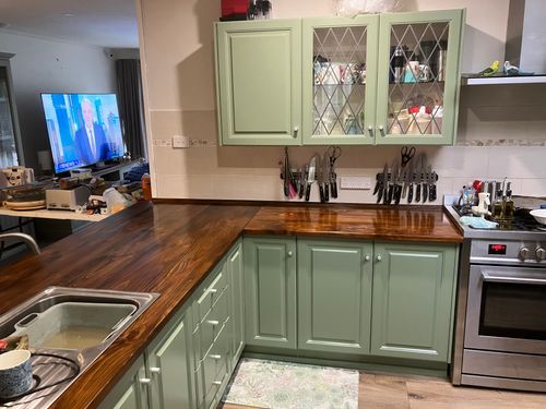

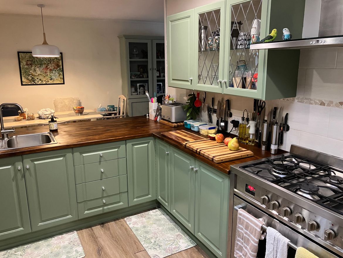

Finished ProjectA 40+year old kitchen with peeling cupboard doors and drawers, that felt “boxy” with a partial opening with a raised serving shelf, facing into a small dinning area.

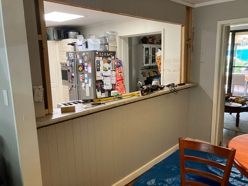

This shelf, walls above and beside benchtop were removed this instantly achieved a more open kitchen and dining area. All doors and drawer fronts were reused after removing the old vacuum bonded coating, using a heat gun. Then sanded until all glue was removed and were sanded smooth.

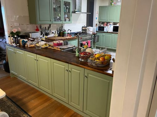

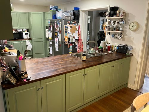

Next removal of old sink and old benchtops and new sink and tap fitted to stained wooden bench top I had made at home.
I made the larger bench top to extend into the dinning area so i could make and install cupboards underneath for additional storage space. I matched the doors with Kaboodle Alpine style to blend in with the older kitchen doors.

Removal of serving ledge including, the upper wall.
Patching gyprock and painting where old walls were.

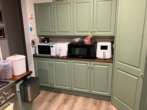

Removing all the old vacuum bonded plastic covering on each door and drawer with heat gun.
Sanding each component until all glue was removed and sanded smooth.
Build new timber bench tops cut out for new sink.
Stain finished bench tops and apply Marine grade varnish.
larger bench top was made to extend into the dinning area so I could make and install cupboards underneath for additional storage space. I matched these doors with Kaboodle to blend in with the older kitchen doors.
