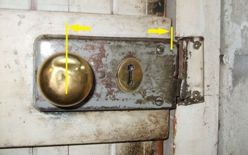

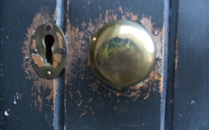

A mate of mine called me up the other day, as he's just bought an older type house and he would like to be able to secure the garage door.
These were the pictures he sent me of the lock-set that is currently installed in the door:
Inside of door
Outside of door

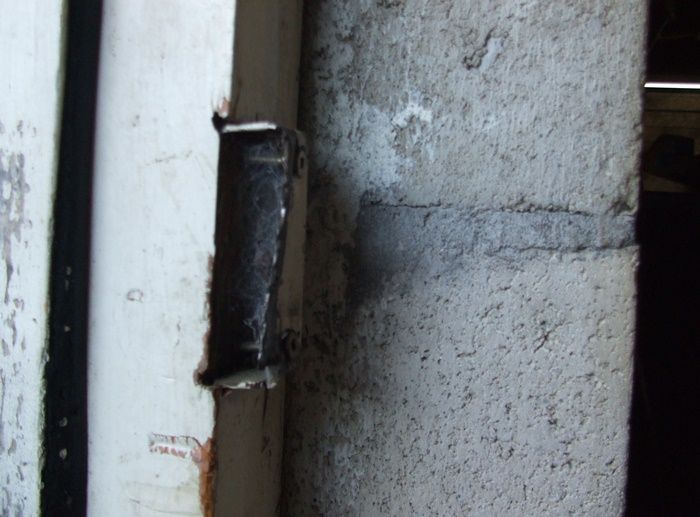

Existing door catch
Bearing in mind that this is a door that is made out of tongue and groove timber slats, with a strip of timber across the centre of the door that holds the existing lock arrangement in place.
The catch has seen better days as it is all bent out of alignment and sometimes does not lock or unlock.
The width/thickness of the door and the timber strip on the back of it is approximately 42mm.
The width of the timber that the catch sits on is 45mm, between the rebate in the frame where the door contacts when closed.

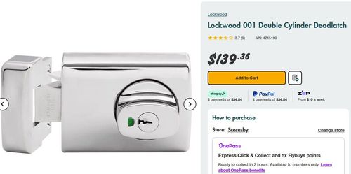

The guy wants me to convert this to a readily available lock set and striker plate, looking through the Bunnings product list,
I'm sort of at a loss as to how I would do this, I have some ideas, but I need your thoughts as well.
