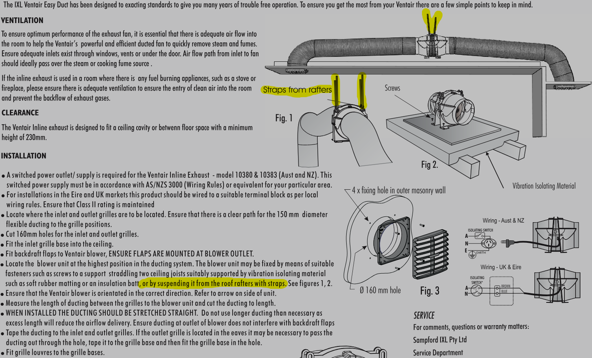

My question is, The instructions call for hanging the fan from the truss's via what it calls "strapping"
It doesn't say what strapping to use or how to fix it to the truss's
Here is a picture from the instructions
thanks for any help, joshy
