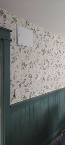

Room divided into two..
.1..framed and lined with V groove MDF..
.2...Nail and screw holes filled and sanded.

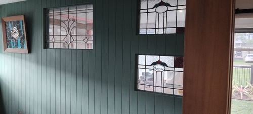

3..Window opening cut out.
4..walls sanded and used
4n1..,sealer,primer and undecorated ..
5..1top coat of green..
6..windows installed.
7...filled and sanded all nail holes around window frames...
8..4n1 sealer,primer,undercoat applied
9..1top coat applied
10..final coat over wall and windows
Step 2
Framing went up as plans.
V groove MDF panels installed,window cutouts were next ,filled and sanded all nail,screw holes...then application of 4n1 sealer,primer,undercoat on MDF V panels.
next day windows installed filled nail holes,sanded...4n1sealer,primer and undercoat on windows..
When dry...painted 1 coat of green.
Skirting board added...holes filled and sanded,4n1 primer,sealer undercoat painted on...once dry 1 coat of green applied.
Next day...final coat on wall,windows,and skirting ...yah!!!
