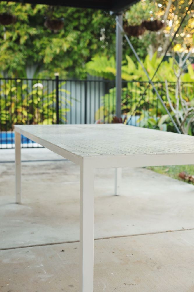

I found an old outdoor glass and metal frame table on the side of the road that was destined for landfill. I loved the contemporary, clean shape of the table and thought it would be perfect for a tiled tabletop makeover. Using white grid tiles and spray paint, the table now has a modern look and is ready for outdoor entertaining!

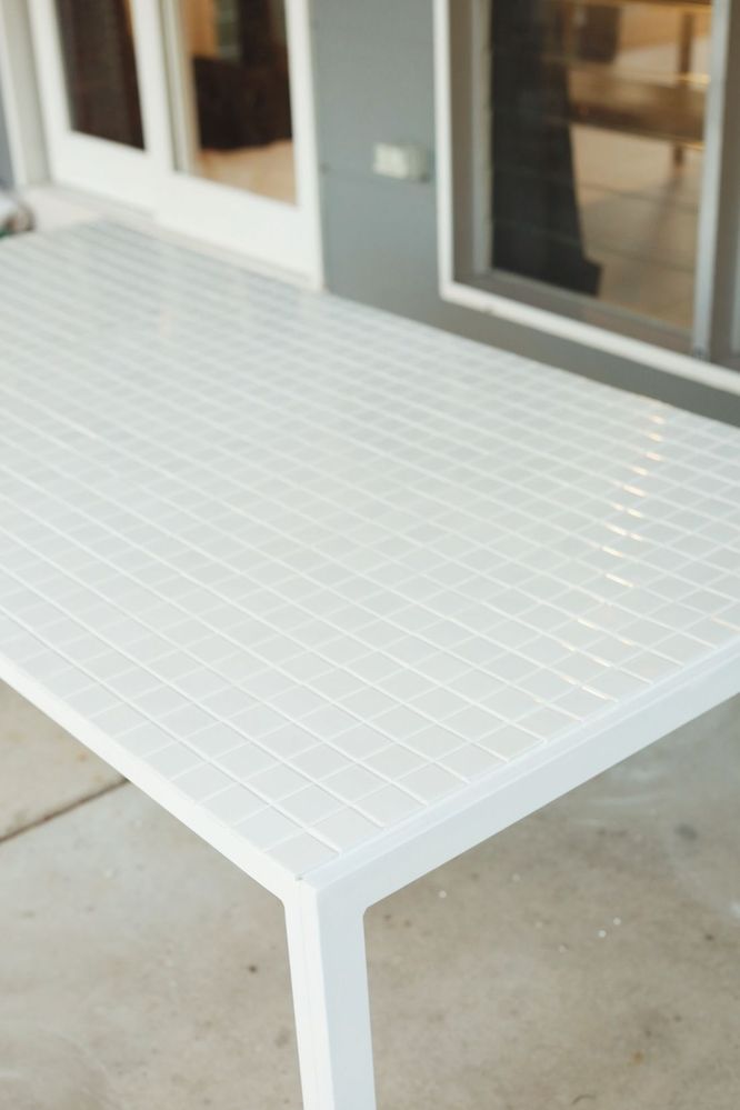

Spread a layer of tile glue using a notched trowel, then press the mosaic tile sheets into place. If you don’t have tile spacers, you can improvise — I used paddle pop sticks and they worked fine!
Tip: If your table is an odd size, you might need to cut tiles. I avoided this by allowing a 3–5mm overhang, which achieved a neat look and saved so much time.

For a clean edge, apply white silicone around the perimeter of the table. This seals any gaps and gives the table a polished finish.
