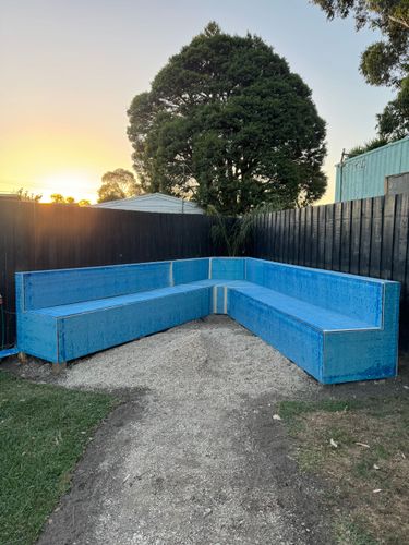

Step 1
Made the seat out of timber framing and blueboard

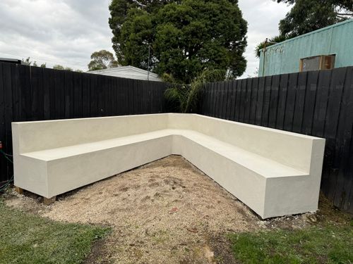

Step 2
Rendered and painted bench seat.

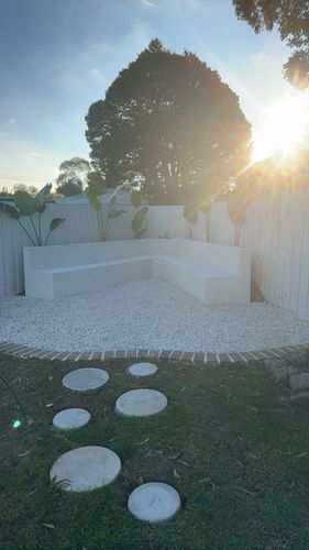

Step 3
Added brick edging and wide joint mortar in between. Then added plants behind bench seat and white stones on the ground inside brick edging.

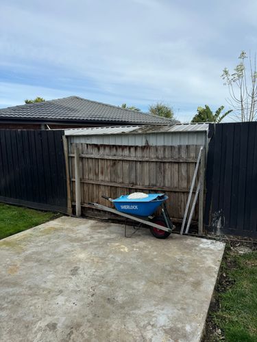

Step 4
Then created the green plant panel wall from Bunnings. And built pergola over the top of an old shed concrete slab
Included a before photo.

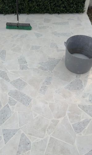

Step 5
I got some cheap outdoor tiles and smashed them all up into pieces and glued them to the slab to create a crazy pave area - then grouted and sealed.

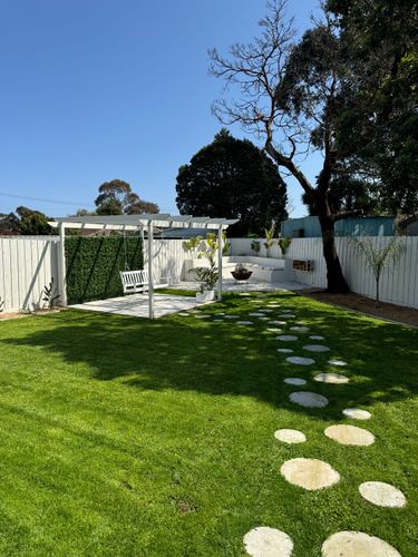

Step 6
Added a bench swing from Costco and added some pot plants. Then added round stepping stones in 2 sizes from Bunnings to make a pathway leading up to the area.
