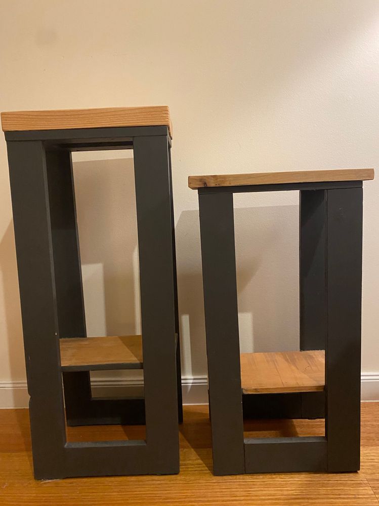

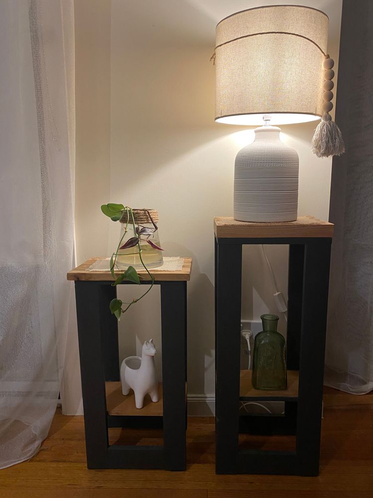

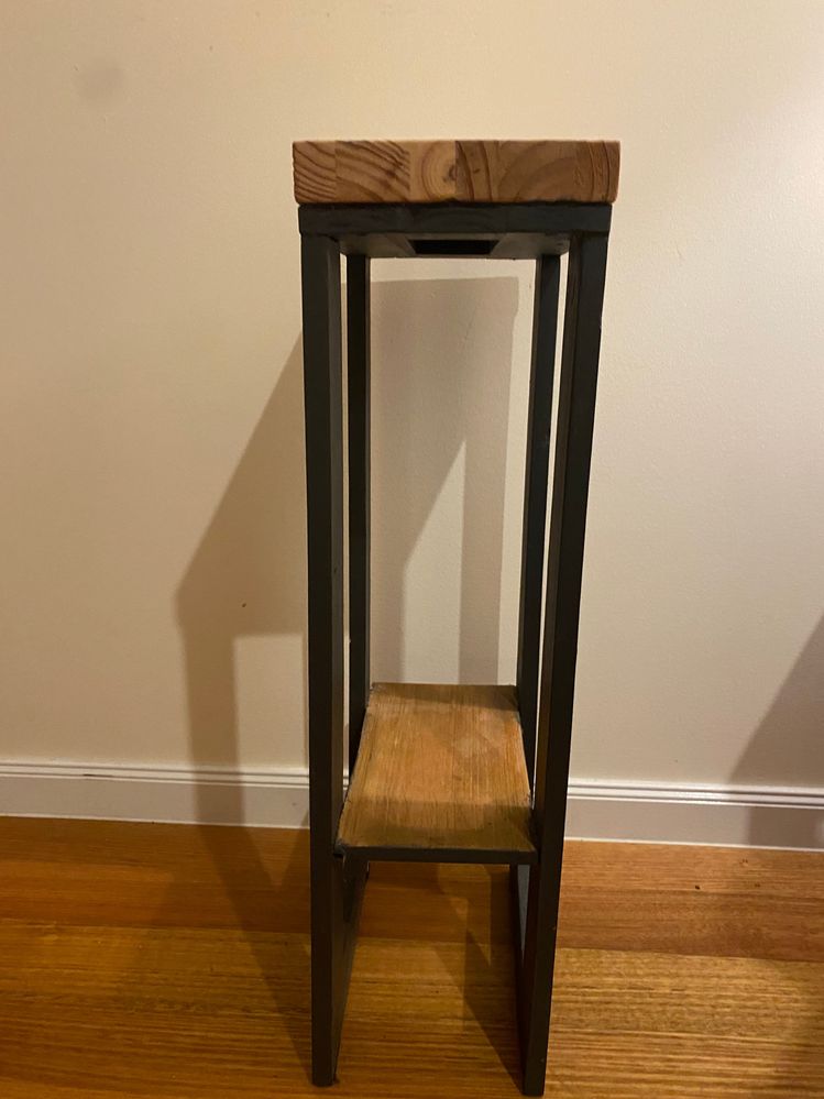

I wanted a lamp near my couch but most tables to too wide in the walkway,so I made a pair of slim tables that now fit perfectly in a small area along the wall. They match the dining table I made from the U shape metal legs.
They are made from off cuts I got in the timber yard at Bunnings.

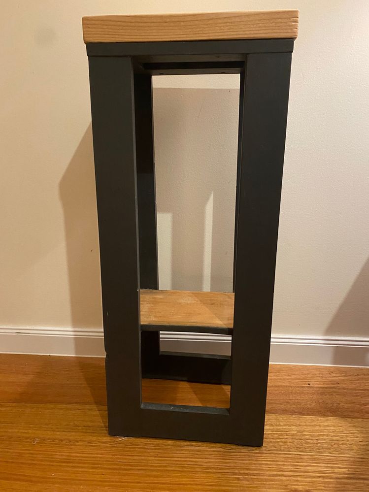

*Measure height, cut four legs each table
*cut two cross pieces to form a U shape at bottom
*cut top and lower shelf
* sand each piece
*glue and screw everything together
* attach table top, sand and beeswax
* paint the legs
