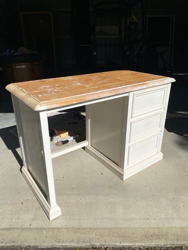

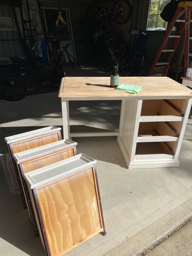

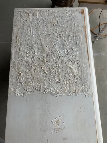

We sourced the study desk (hero piece) and set about refurbishing it. It had a thick white glossy paint that we stripped using a paint stripper and tool, before sanding all over with both the orbital sander and detail sander. The drawer rollers were in excellent condition, so no repairs were needed.

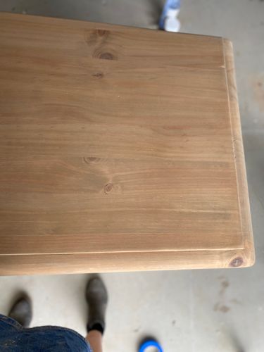

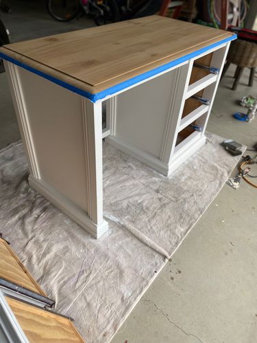

We paint washed the pine top using Dulux ‘Jarrah’ (90/10 ratio), applying 3 coats followed by another 3 coats of watered down Cabot’s Walnut Stain for that weathered oak finish.
The drawers and base/sides were primed with Zinnier 1 step Primer (2 coats) followed by 3 coats of Dulux Snowy Mountain Semi Gloss.

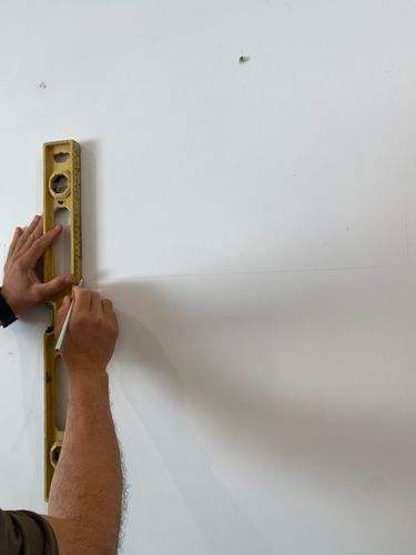

Securing the Scalloped shelves first started with measuring the space and marking out the screw/wall mate positions. We chose to have the shelves sitting flush together to give the impression of one large floating shelf.

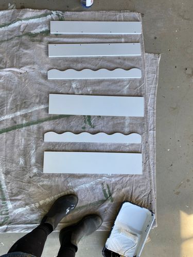

For cohesion, we primed and painted the shelves using the Dulux Snowy Mountain semi gloss after a quick scuff sand.
Putting the shelves up was possibly the most time consuming part of the whole process!

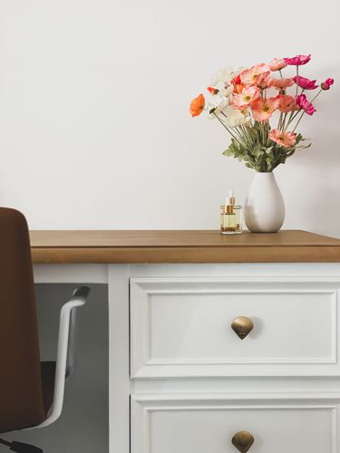

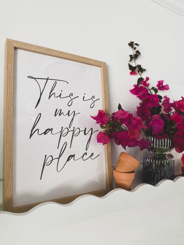

The Mediterranean beach brief meant we opted for a solid base of crisp white, weathered oak and rattan/seagrass textures with pops of bright seaside colours - sky blue, teracotta, rich red and lemon. Framing art found in magazines allowed us to transform the shelves on a budget and using fresh Bouganvillea from the garden really gave it that luxe resort feel. The tan/white Desk Chair compliments the vibe.
Every tween loves a little bit of luxury, so we used glass dropper bottles with gold trim to showcase some homemade body oils with dried flowers.
The best bit? As our tween grows and her style changes, she can restyle the shelves on a whim.
