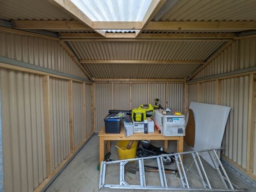

I'm converting a metal shed to become an outdoor office. I'm unsure on the best approach to insulate.
I've read many posts on here but still unsure on best approach.
Based in Adelaide, so humidity not an issue, concerned about tempature in summer, was thinking about using Earthwool 75 wallbatt due to its acoustic and rvalue and foilboard for the ceiling but wondering if foilboard would be good for the whole thing?
There's no plastic or radiant barrier currently in the shed if i went with the earthwool for walls would I need to somehow retro fit that or is the moisture resistance of earthwool suitable?
(Skylight Will be removed)
Thank you.
