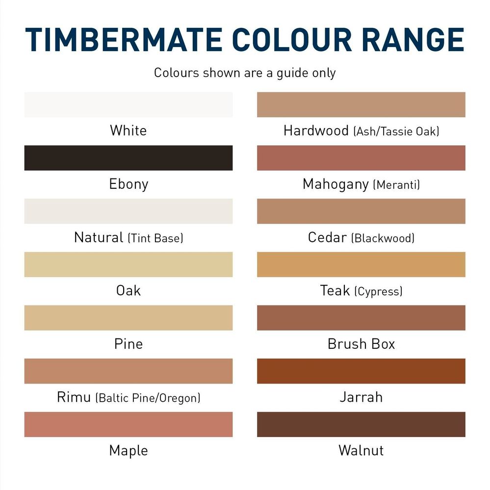

To fill gaps between timber floorboards, you can use a wood filler such as Timbermate. Timbermate wood fillers come in a variety of colours. Try to find a match to your flooring.
