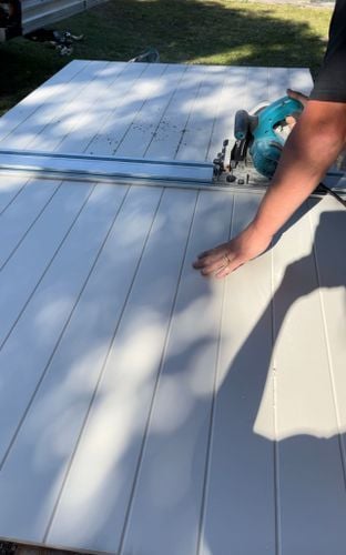

Step 1
Measure and cut panelling to size using your track saw.

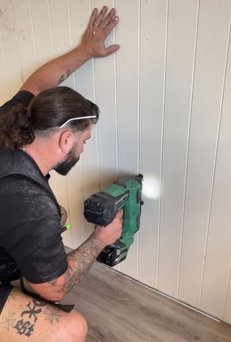

Step 3
Secure VJ panelling to wall with nails.

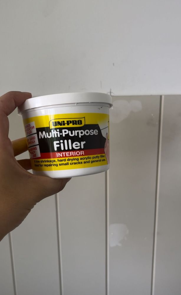

Step 4
Fill nail holes and joins and allow to dry. Here is the product I used.

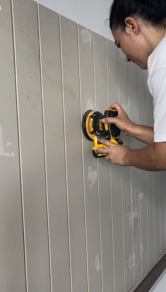

Step 5
Once dry, lightly sand filler.

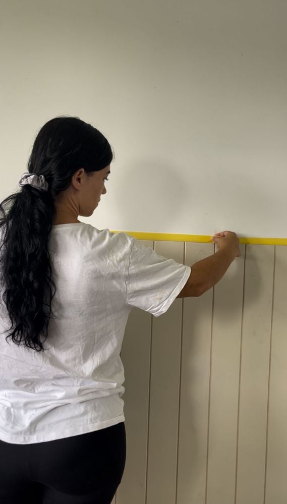

Step 6
Use painters tape to tape up surrounding areas before painting. I used Frog tape.

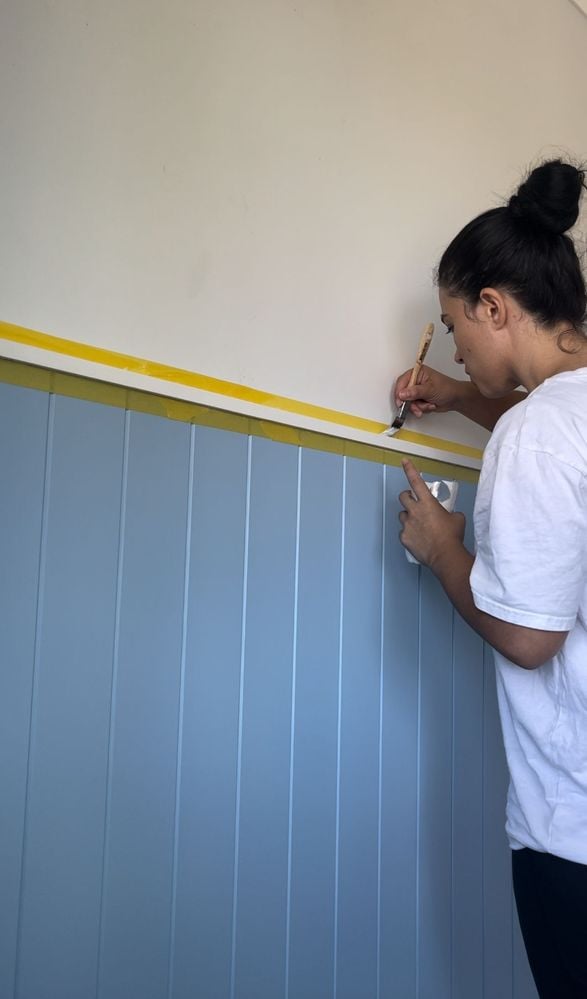

Step 7
Cut in using a brush. For this project I chose to use a smaller brush to minimise any thick cutting in lines. This part can take a while so avoid any thick layers of paint as they may start to dry before you use your roller leaving 'thicker' lines.

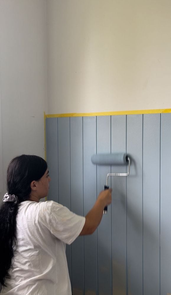

Step 8
Once you've cut in, use a roller to paint the rest of the panelling. You will need to do two coats.
