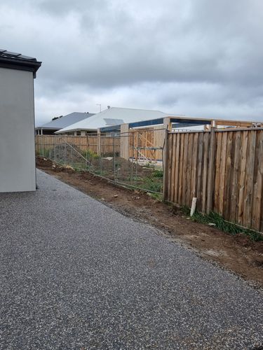

I am wanting to level block in backyard. Putting 2 sleepers high retaining wall 400 high along fence line.
Do I need to worry about drainage or what type of rocks can I put in between retaing wall and fence. Gap will be aprox 250 to 300

I didn't think it would get this confusing. I did upload pictures for you to look at:)

The reason on the outside is that's where the soil will be built up to level block. Wall between fence and retaining wall wont be any built up of soil maybe scoring for drainage
The retaining wall is getting done only so we can build up soil to the concrete to level block and wont damage fence. I have attached picture.
When I was referring to the outside, I meant the side facing the fence. It makes sense on the side where the soil is being built up.
