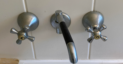

Could someone suggest some 1/4 turn ceramic disc taps that I could buy to replace the laundry tap shown in the photo? Thanks.
Hello @wendy001
There are two options for your ceramic upgrade. First is to replace the entire set with a Mondella Chrome Cadenza 1/2 Turn Wall Top Assembly. I understand that this is not 1/4 turn, but it is a complete set with no need to worry about handle and flange compatibility. Second is to replace the existing spindle only with a Shaw & Mason Chrome 1/4 Turn Clockwise Ceramic Disc Basin Spindle (one for hot and cold).

Thanks @EricL https://www.bunnings.com.au/mondella-chrome-cadenza-1-2-turn-wall-top-assembly_p0684129 is the exact information I need. I am not very practical, so will use Bunnings' installation service. Thanks so much for the advice.
