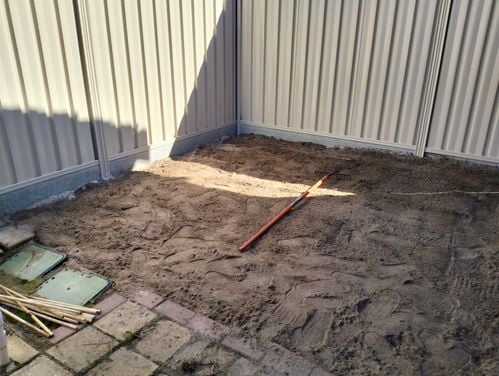

Hi, I want to install a garden shed (approx 2 X 2 metres) in a location where there is a water pipe and electric/gas lines underground, so I can't dig too deep, and I need it to be movable without a huge amount of effort in the case that something needs to be accessed in the ground. See the area in the photo below...

* Firstly, does a wood base seem like the best way to go considering my requirement for it to be movable and not require much digging?
* In the video I linked above, the base uses concrete blocks to rest the wood beams on (I know something like TuffBlocks can also be used). I've seen some videos that just have the wood resting directly on the ground with anchor points going into the ground. Just wondering which would be best for my situation. There's a slight slope on the ground, but I think I should be able to level it fairly well.
* Also, in the video he puts floor sheeting (OSB) down on top of the frame. I'm just wondering if I would need floor sheeting given the Lifetime shed will have its own flooring. Or will this help to keep it level or provide better anchor points for the shed floor? Do you have any other suggestions for what to put on top of the frame?
* What timber would you recommend for the wood frame? Would H3 treated pine be ok (i.e. 140 x 45mm Outdoor Framing H3 Treated Pine - 4.8m - Bunnings Australia), or would H4 treated pine be better, or something else?
* Should I put down a gravel or similar base under the timber frame base, or is it ok directly over soil?
