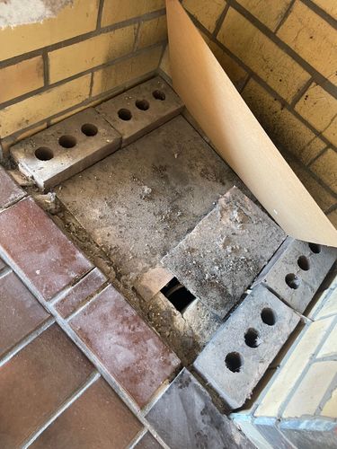

Need some tips and suggestions on what to do with this cavity, particularly the base as it’s exposed to the subfloor - What would you use to cover this?
Recently had the gas heater removed and have no intentions of replacing it.

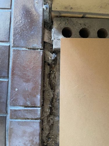

1. What do cover the giant hole that exposes the subfloor? Would I need something stronger than plywood? bare in mind I want to tile over it.

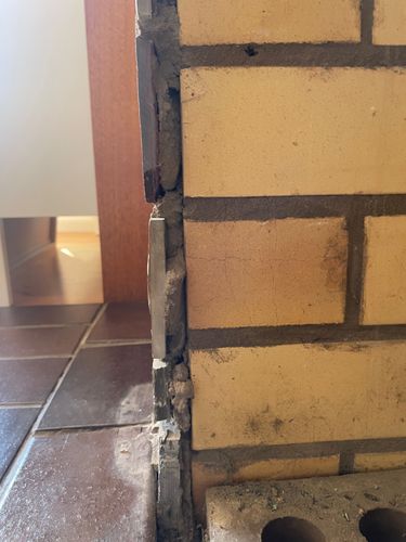

2. Can I panel over the slate facade or am I best to remove this, clean it up and panel over the brick? Cheers!

What would be the best material to for the base of the cavity? It just a whole into the subfloor at the moment and my intention would be to tile over it. Thanks 🙂
You do have other options such as using STRUCTAflor 19 x 3600 x 600mm General Purpose YellowTongue and then placing James Hardie 1800 x 1200 x 6mm 2.16m² Ceramic Tile Underlay Flooring. You can build a timber base formwork and pour cement to create a concrete floor. There is also the option of using bricks in combination with the timber base formwork. It all depends on how much work you wish to put in regards to covering the opening.
