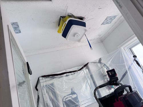

+ heat lamp, lamp and exhaust fan combo: should I replace it or try fix? Both heat lamps work, and middle light, but fan does not (well you can hear the slightest whir, but it does sound like it has given up on life.
I have a tiny granny flat, which is completely separate, not even the same main entrance from the street (corner block), but was originally under the same roof as my house. I haven’t had much access to it for a while (my own fault as the tenant was a little intimidating, almost had a forcefield, despite a proper rental agreement, so it was just easier for me to ask her to let me know if there was anything that needed maintaining). Lesson, very much learnt.
But now that I do and after about 30 hours of the horsehair ceiling in the bathroom is sagging and will definitely need re-strapping, but also need to either fix the motor on the IXL unit as the lights still work or replace. It’s hardwired so obviously with a sparkie. Not necessarily her fault of course.

- The IXL hole was cut too large (classically packed with cardboard) and the straps are broken and it is falling from the ceiling, but I have only just started on getting rid of some of the nearly 100 years of dust up there (not the tenant’s fault of course). So both of those probably don’t help with the integrity of the horsehair?

- I took the cover off and I actually initially wondered if there was some kind of thin layer of foam insulation, but no it was a thick layer of dust. Hence the rather strange looking contraption I have attached for when I start getting stuck into the roof space vacuum. It’s wonky and unconventional, but I’m injured, so I’m just doing what I can.

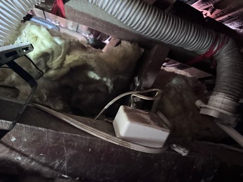

- I have to vacuum up there regardless, but should I attempt to see if the fan will get a second wind or just remove it and replace? If so, suggestions? I need a sparkie for some other things regardless, but I know my sister has one that has a powerpoint in there, rather than mine which is hardwired. Is that a better option? It is small as I have mentioned, so I do like the idea of the combo of heat lamps, light and exhaust fan with more than a whirr but not sounding like a public utility block hand dryer. Those dimensions are 425 x 220 x 35. I could go a tiny bit larger as the original hole is too large. It will pull back if properly installed and the ceiling is fixed I guess.
- And the ducting is plastic? Is that normal?
