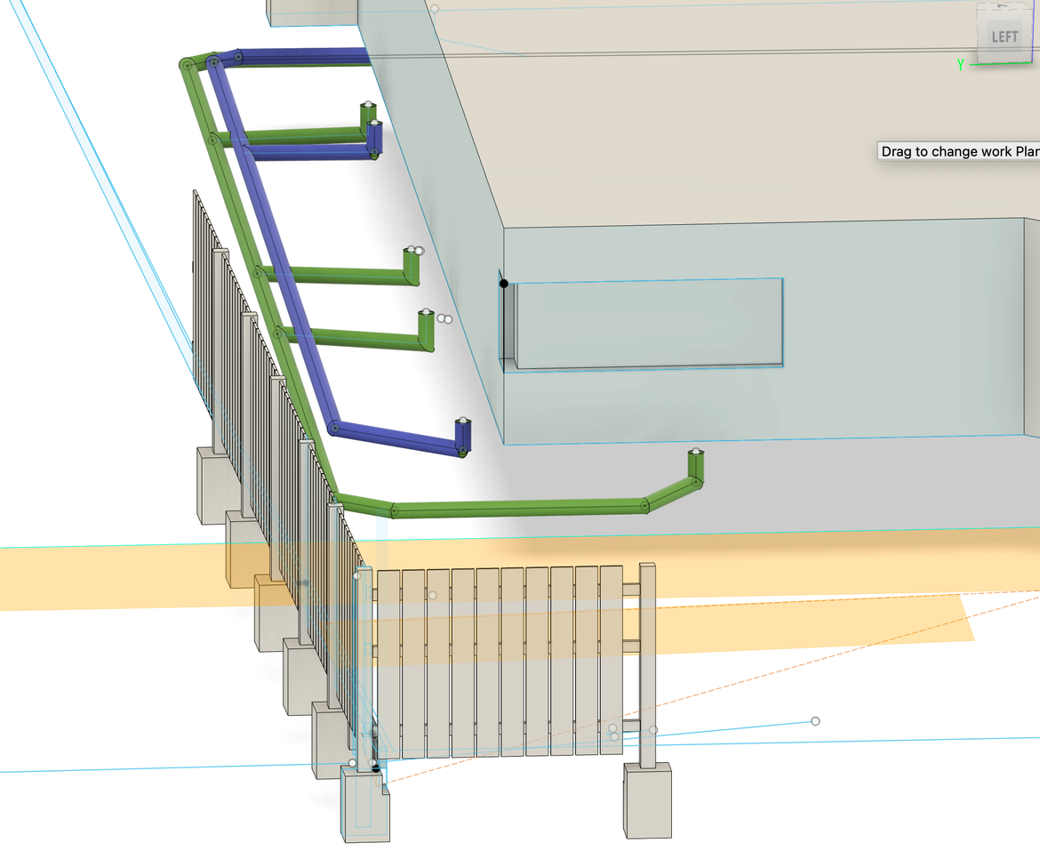

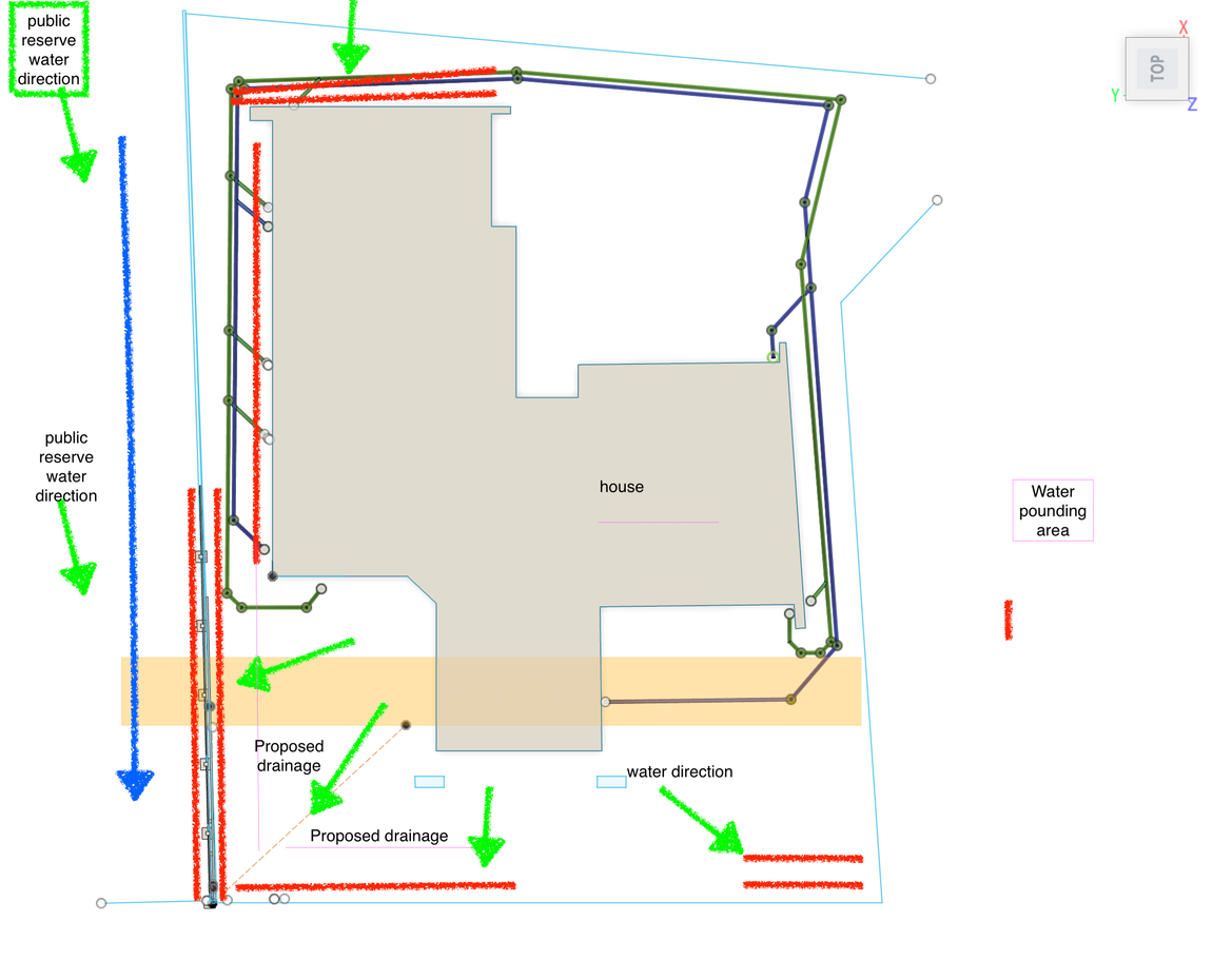

Thanks for you help. The reserve next to my property is very wet during winter and ponds water in this area. Some run off is pushed towards my fence line. Down the back of property had issues with water channeling along brick of the house . ive graded it to fall to the fence instead.

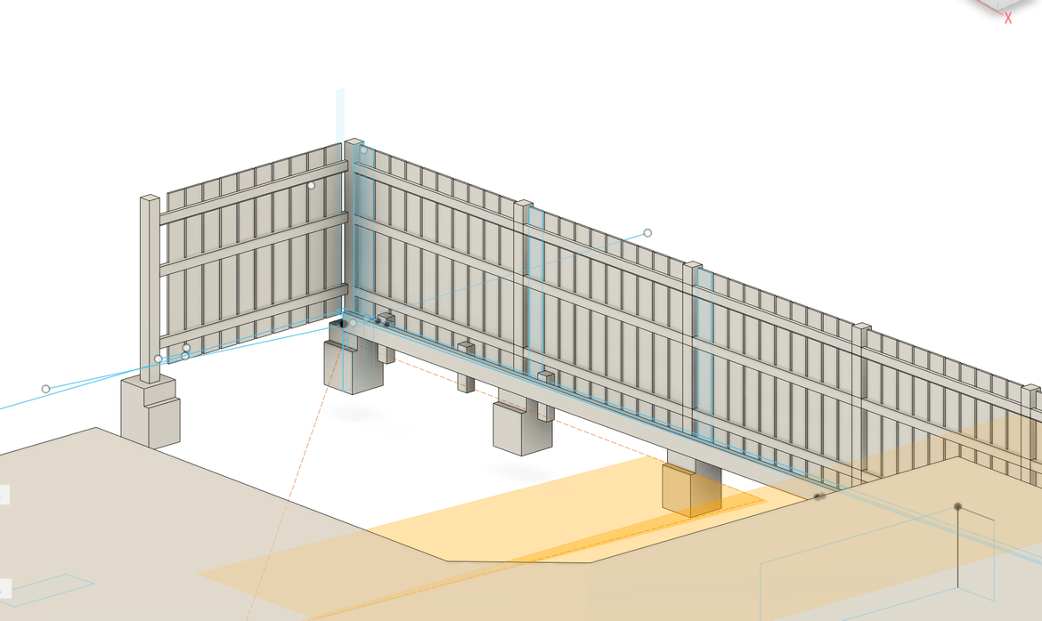

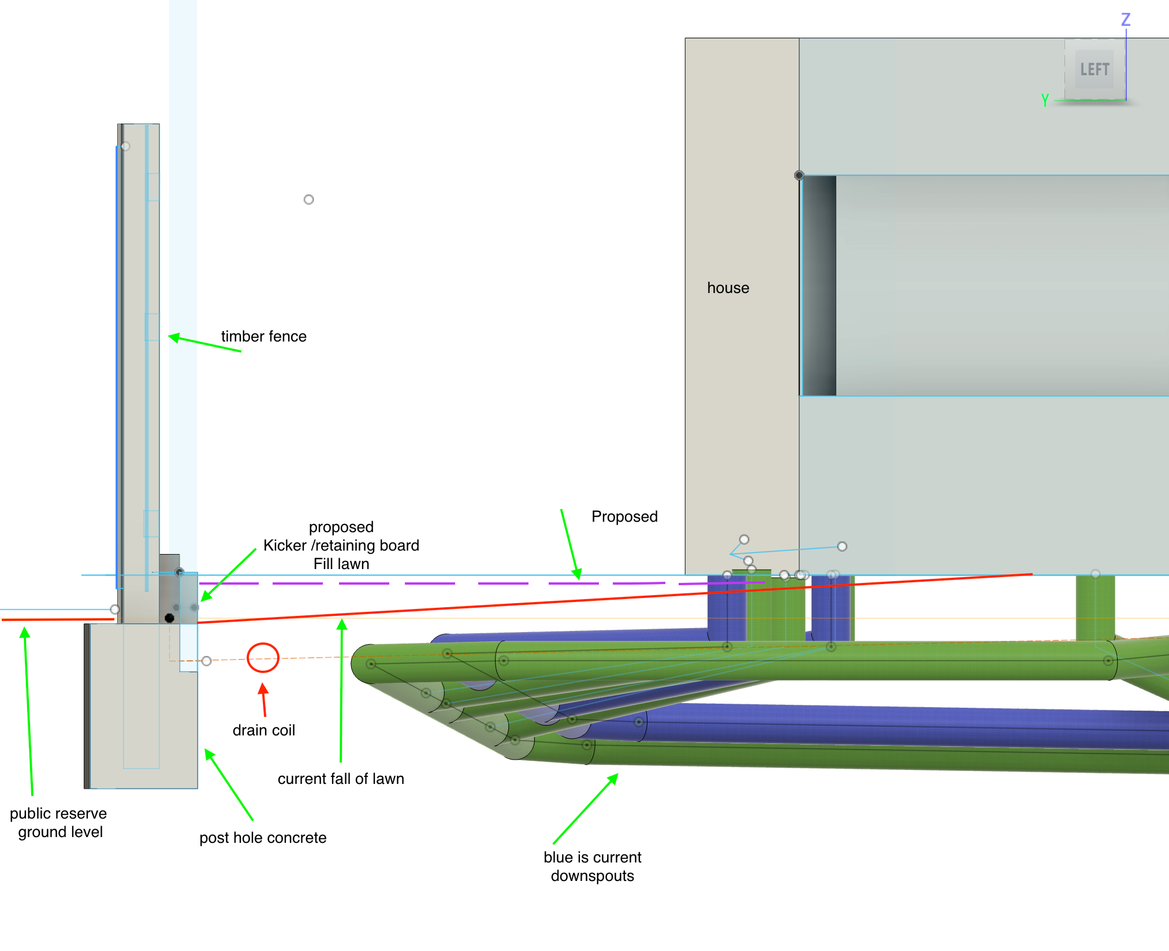

I want to put like a kick board/ retaining wall on my side it will only raise the lawn by 100mm in the corner and will run drainage and plumb back into the storm water line.
Areas i have concerns.
1/ the kickboard/retaining wall cliose to the fence and notced around the posts where below the surface.
2/ back filling up to the kickbosard/retaining timber on the reserve side and my side ?
