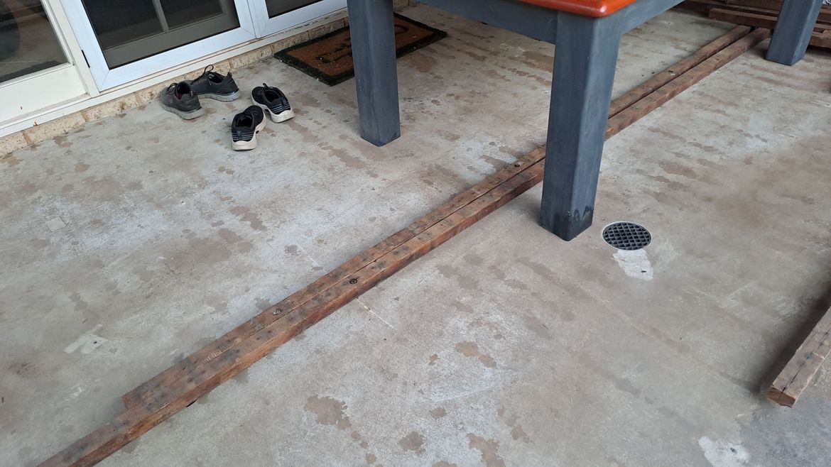

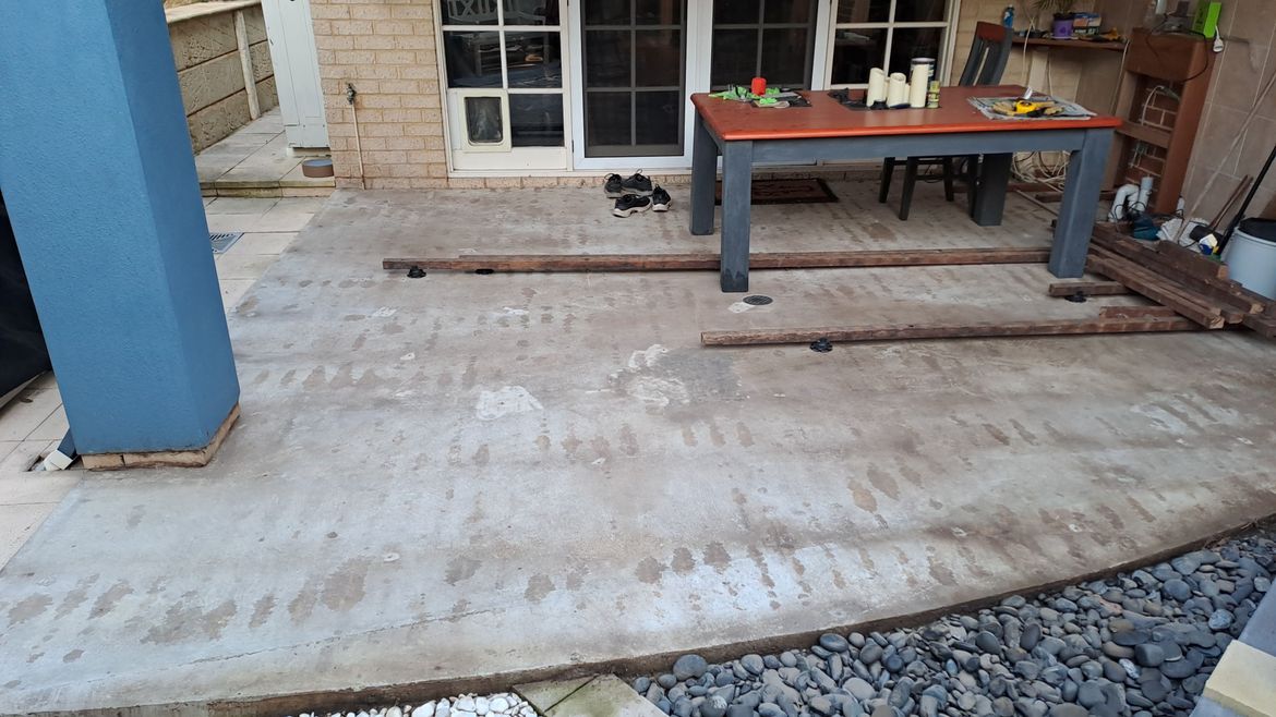

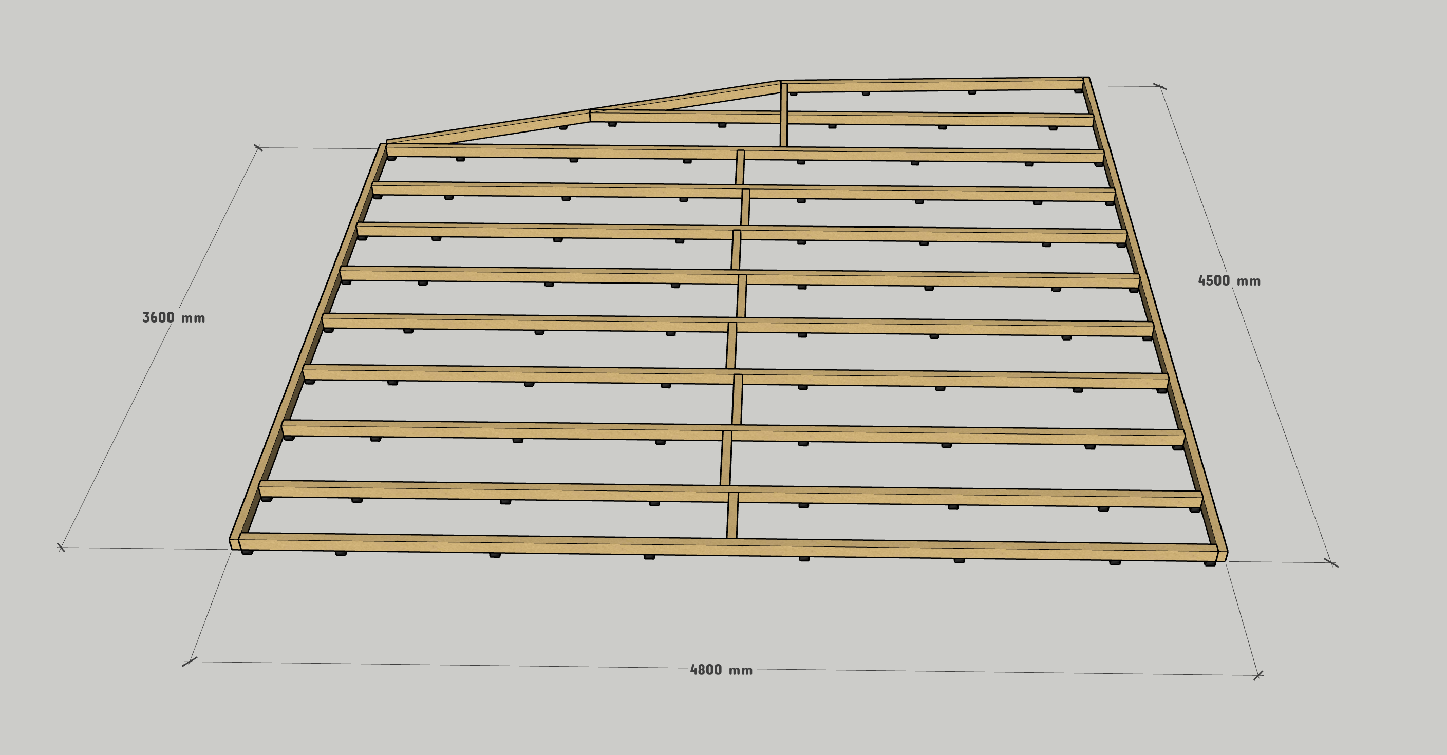

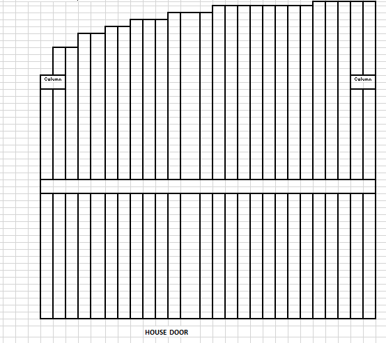

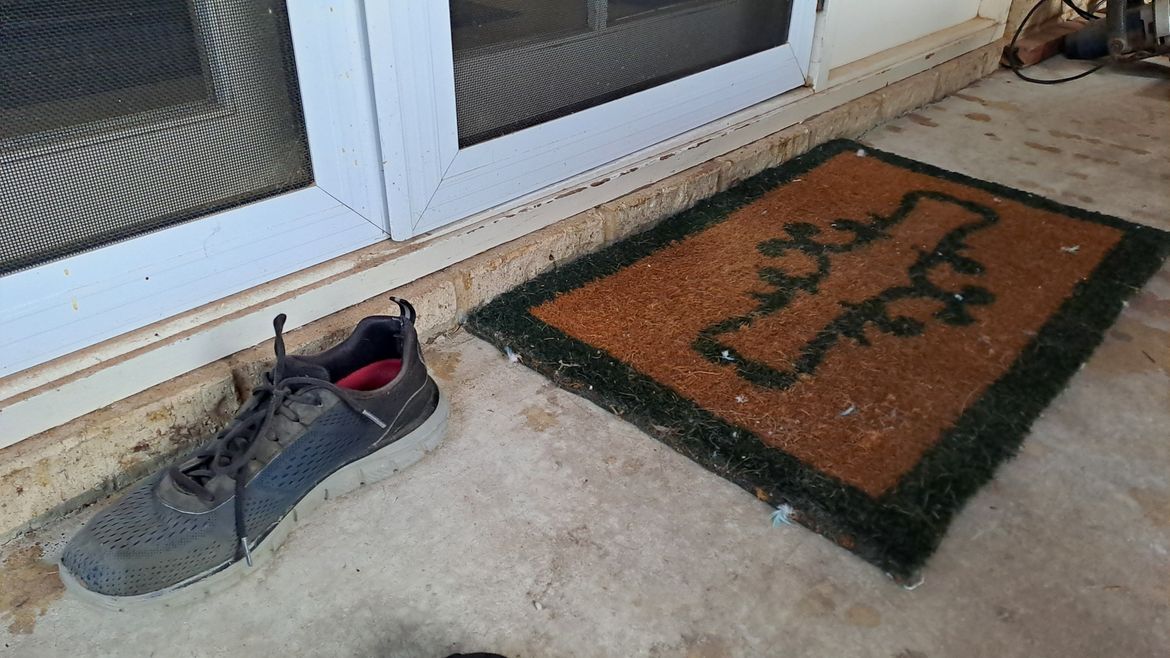

Hi all, I'm doing some low level decking and wanting to use the Bunnings 42mm x 42 mm (pencil rounded) Merbau timber for the joists. They will be on a concrete slab but I'm really limited to the height, hence the need for the 42mm x 42mm.

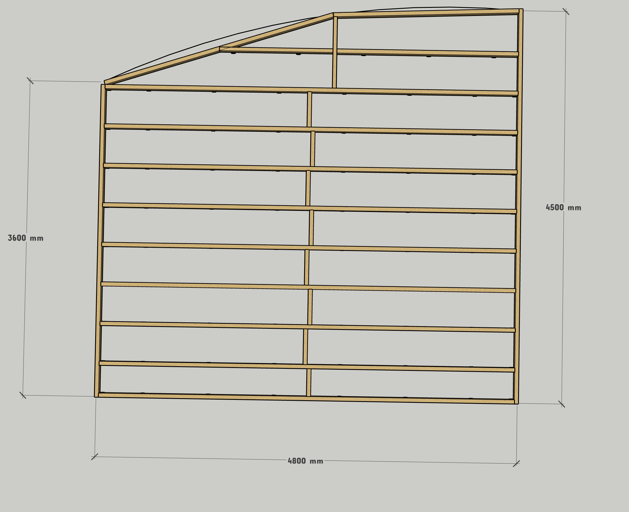

I propose Bunnings mini feet for the bearings.
I'll be applying Ekodeck boards (180mm width) on top with 6mm gaps. Area is 22m2.
Height, off the concrete, for the joists will range from 10 mm to 40 mm (Yes, very low level).
I'll be applying bearer protector (CA group) G-tape onto the tops of the joists.
The concrete has a drain in the middle with slope towards the drain from each side.
Most of the decking (say 2/3rds) is permanently in the dry, under cover. The exposed area cops the Perth weather.

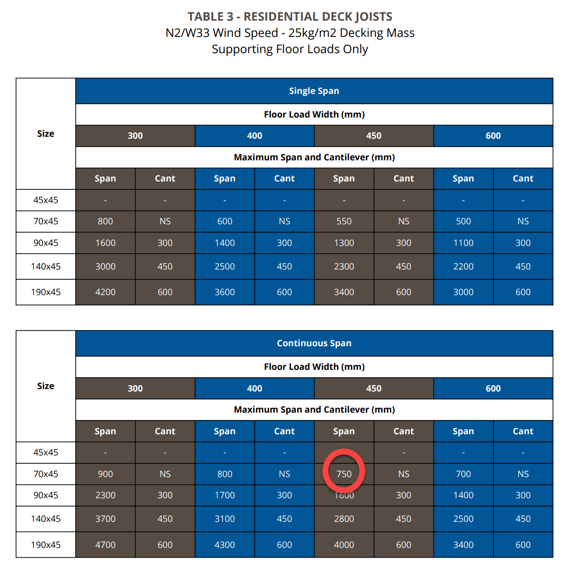

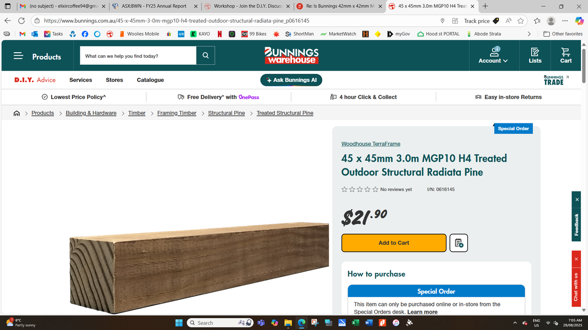

The merbau timber is rated to Class 1. Initially, I was looking at a H4 rated softwood (Radiata Pine) for the joists (due to the low height off the concrete) but from what I can see, the span for them is 250mm and that would involve around 200 bearers.
Wondering what the span capability is for the Merbau hardwood and whether people more experienced than I am, would say it's up to the task given the low level.
