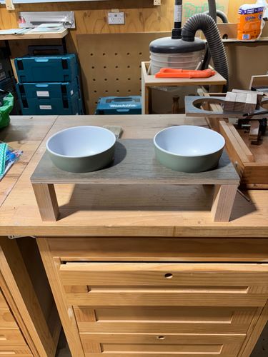

Here is a simple little project to make life easier for your cat, I read that a cats feeding bowl is better if it was elevated a little bit making it easier for the cat to digest the food, I made this stand using left over pieces of floor board and timber for the legs.
Overall size, 430 mm long x 200 mm wide x 120mm high.

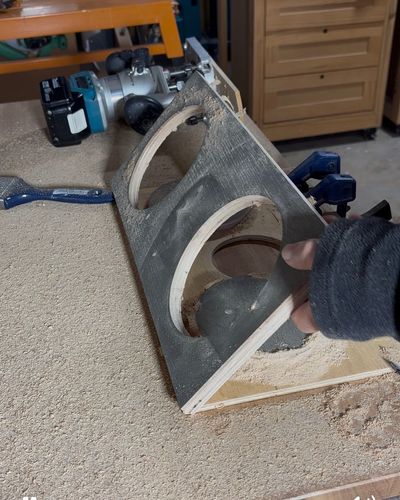

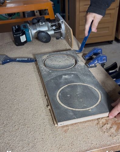

Makita 18 volt trim router
Home made circle cutting jig.
Makita mitre saw.
Double sided tape to hold timber in place whilst routering out the circles.

Steps
Step 1
Cut timber plank to size

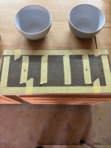

Mark out circle size to suit bowls
Cut holes for bowls using router and circle jig.
Sand all edges.

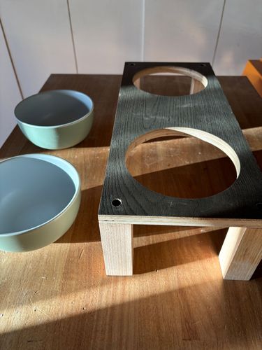

Measure and cut 4 legs.
Step 2
Drill and screw legs to timber top.
Apply two coats of varnish
Add rubber pads for bottom of legs.

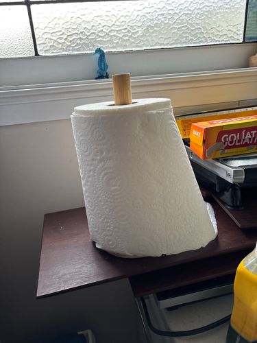

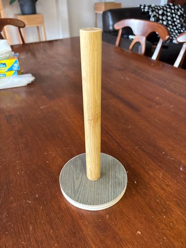

I made this paper towel holder with the offcuts
