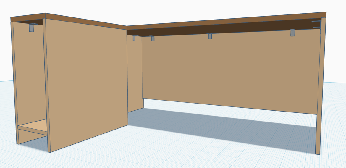

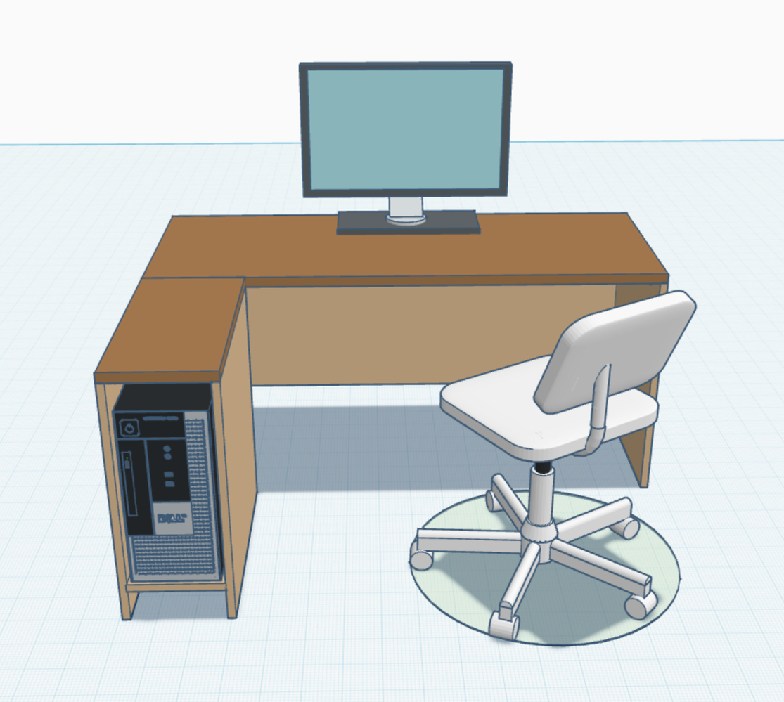

I am trying to make an L-shaped desk for my gaming setup with a place for my computer tower to sit off the floor. I have already thought about what came to mind but I've never done this before so I was hoping someone might have some insight to what I'm trying to do? I've picked out all the pieces I think I'll need to create it but I feel like I'm missing something. I'd like to try and keep the budget under $500.
Top of the desk - https://www.bunnings.com.au/specrite-2200-x-600-x-26mm-beech-laminated-panel_p8330041

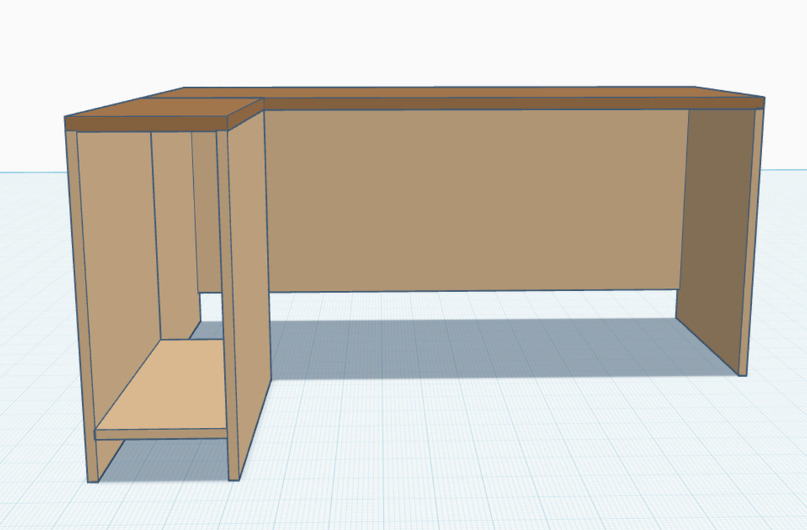

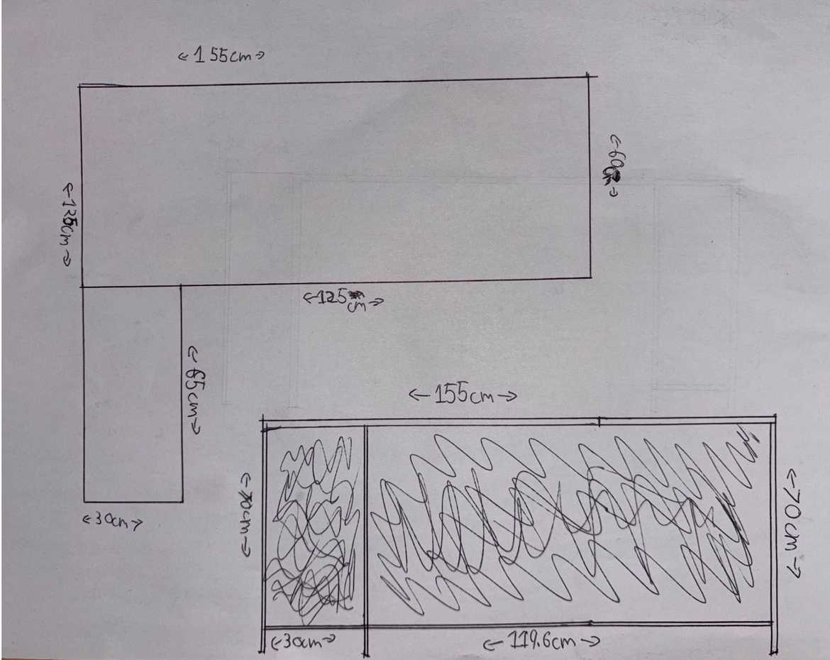

I'll then cut that into two pieces one being 1550mm by 600mm and the other piece will be 650mm by 600mm. However, to use this part as the bottom part of the L it needs to be cut in half at 650mm by 300mm so I have two pieces. One will be used as the bottom of the L and the other part I have no use for at the moment but I will keep just in case.
Then as the legs, I was thinking of using https://www.bunnings.com.au/specrite-1800-x-600-x-18mm-timber-multi-use-pine-panel_p0419624 two of these panels cut into three pieces each. They will be cut into two 700mm by 600mm and one 400mm by 600m each. Then, one of the 400mm by 600mm pieces would be cut into 300mm by 600mm to act as the floor of where the tower will sit. The height of the desk will be 700mm to accommodate enough space to fit my legs comfortably and maybe even my dog haha.
Also get a third one of these panels https://www.bunnings.com.au/specrite-1800-x-600-x-18mm-timber-multi-use-pine-panel_p0419624 to act as support at the back and hold the legs and top together. It would need to be cut down by about 36mm to fit perfectly in between the legs (so cut down to 1774mm by 600mm). I know that it wouldn't touch the ground but would this be fine?
I was thinking of using either these 10mm dowels or these 10mm dowels in the 26mm thick desk top to connect the L parts together then using 6mm or 8mm dowels in the legs and tower holder along with wood glue in places to hold it together better. I don't want to use wood glue everywhere so that I can take it apart easily so I can take it with me when we eventually move.
I'm not sure if I need to use screws as well and if I do what kind of screws and how should they be put in? Any ideas are welcome as I haven't bought the pieces yet. Also, should I stain or paint any of the pieces? At this point I was thinking of staining them to be a bit darker somewhere close to a dark brown so that marks and dirt doesn't show up as much, I know that marks aren't easy to hide but it's my own fault if it happens. Thank you so much!
