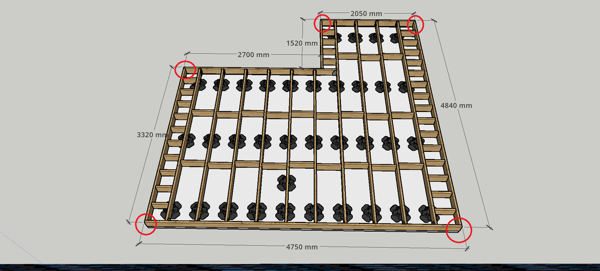

I've been lurking around this forum for weeks for my new mini low level floating deck project. I think I got most of my answers covered, but need a bit of help with this one.Â
First of all, this is my first time building something this big. Go easy on me with the terminology 🙂

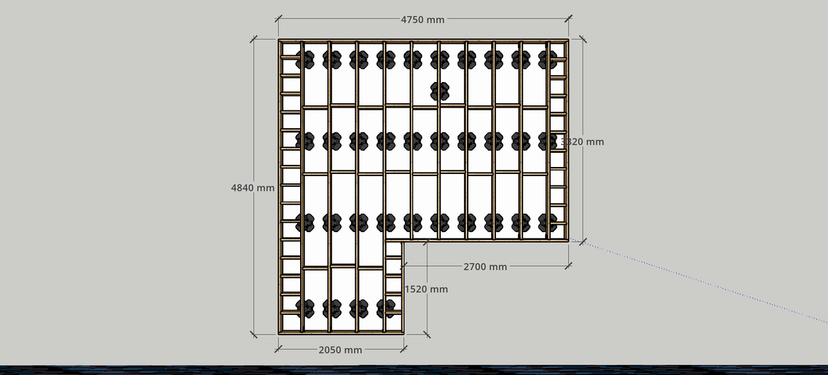

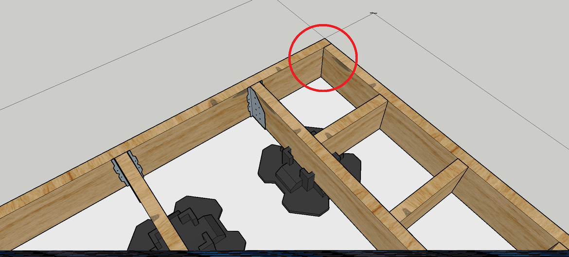

The planned deck is in the images below. My total deck height is only 20cm. So, I chose to work with tuffblocks with 140 x 35mm joists all around. My first question is do you see any faults in this design? Does it seem like I need to change something? Second question is about where two rim joists meet. How can I attach them together? I could not find a joist hanger for that purpose. The only thing I could find which might work is a Boxspan 100mm Galvanised Framing Bracket which seems to be for steel framing, not timber.Â
