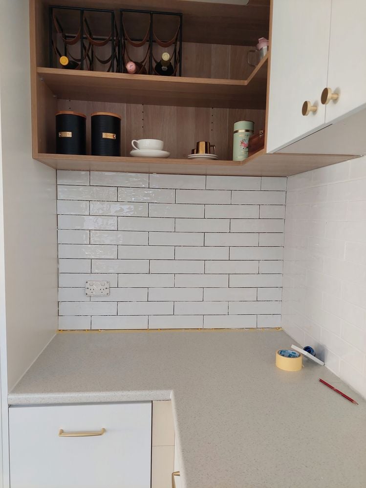

Laying tiles. I prepared the surface with tape, and ensured the benchtop was level. I used spaces to keep the tiles from sitting on the benchtop. I layed the tiles using tile adhesive and a trowel. I used an angle grinder with a tile cutting disk to cut around the power point.

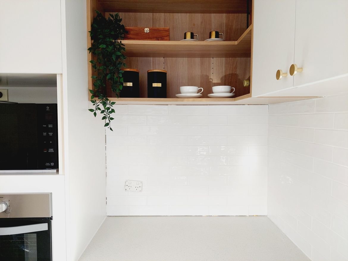

Grouting. I then applied the grout on the tiles using the float ensuring all the gaps where filled and not over applying it.
Step 4
Silicone. I then applied silicone to all the edges ensuring a nice neat finish. After this I cleaned up the tiles and the job was done.
