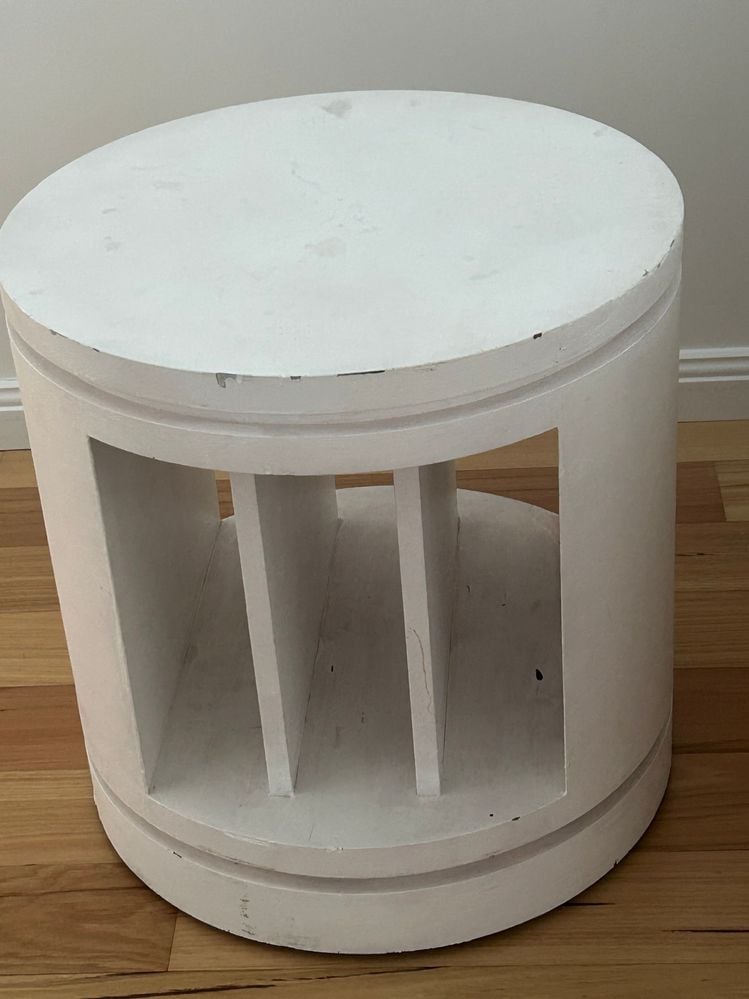

I took a round coffee table/magazine rack and added a new top using a SpecRite round timber Pine panel.

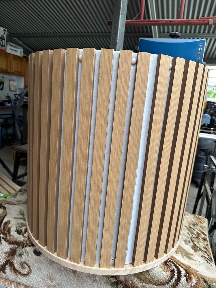

I cut SpecRite timber slat panels in 600mm lengths and secured the top and bottom with tech screws. I then applied Selleys Fast Grab Liquid Nails to the walls of the coffee table, and progressively wrapped and screwed the panels around the coffee table.
I also used quick action clamps to secure the panel as I moved around the coffee table. Finally I used ratchet straps to hold the panels until the Liquid Nails set.
Step 3
Once the panels had been secured I then added 10mm white screw caps to all screws.

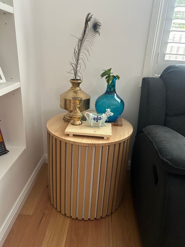

Step 4
Finished project.
