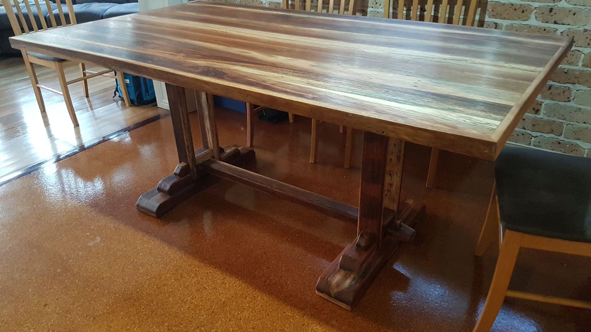

I have only been playing around with wood for 2 months now, and at the start of September i decided to build a table after i completed a coffee table with built in planter box. My ambition vs my ability was very out of whack..lol. I found that the hardwood pallets were mostly gum, so it gave some great assorted colours and grains. I don't have a plan, i just start to build and work from there. Staring at the wood for ideas...lol. The feet were built from the pallet braces, and combining them together. After i sanded it back, i then oiled it twice with 50:50 Linseed and turps, while sanding in between coats. After that i finished off with a couple of coats of Wax applied with Steel wool. Pretty happy with end result.
Added a piece on top to protect table a bit.

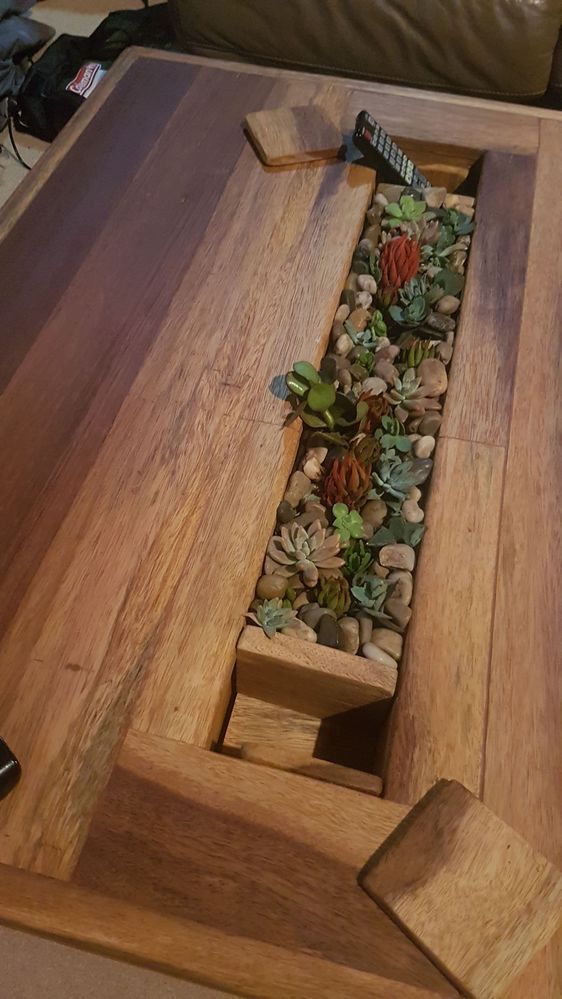

My first attempt at inside furniture. Coffee Table with Planter Box.
