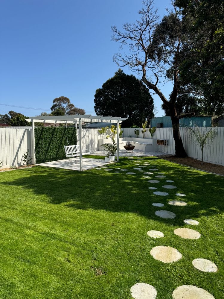

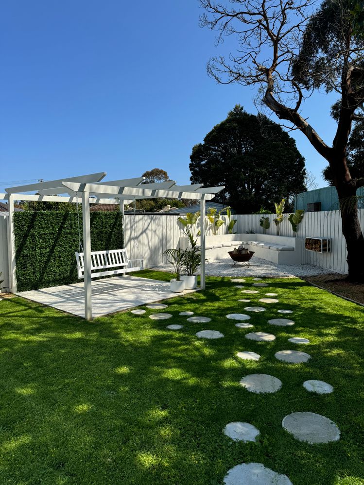

Transformed our backyard into a tropical oasis. Included a fire pit area and an open pergola with swing. With round stepping stones leading up to both. Brick edging as done around the fire pit area and a crazy paved pergola area. Also made a fake plant panel feature wall from Bunnings.

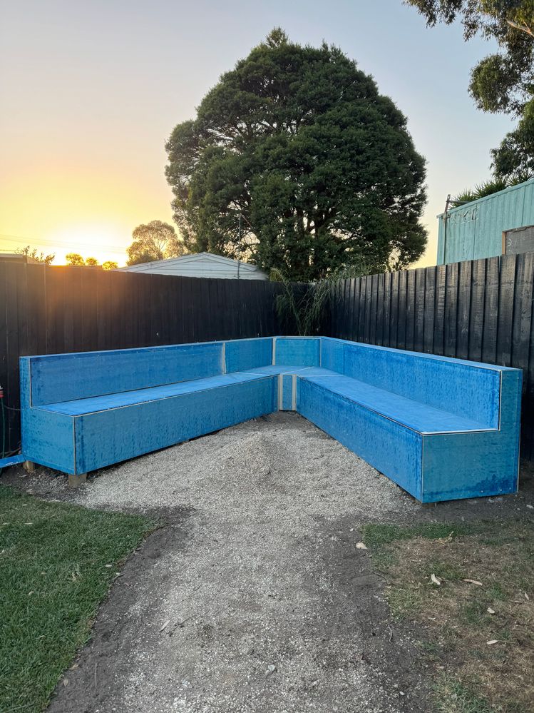

Made the seat out of timber framing and blueboard.

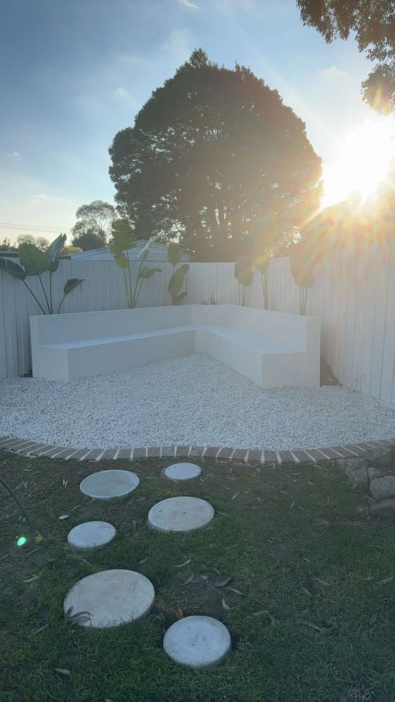

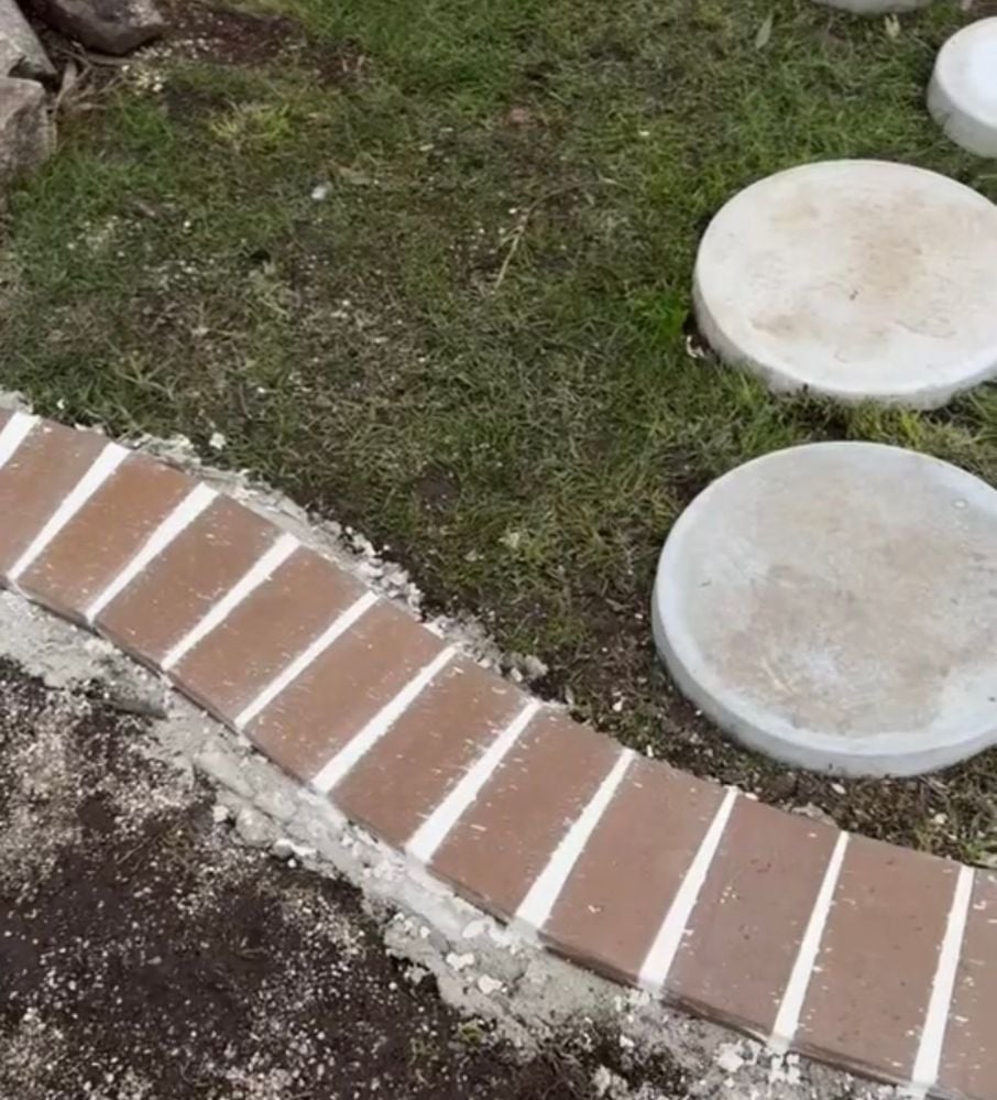

Added brick edging and wide joint mortar in between. Then added plants behind bench seat and white stones on the ground inside brick edging.

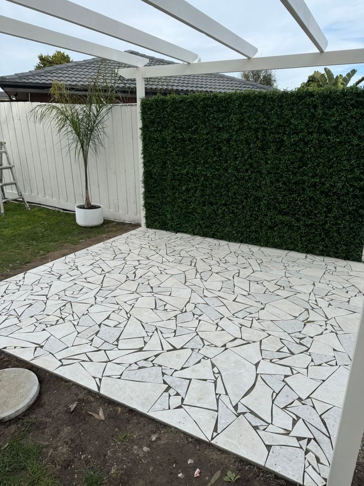

Then created the green plant panel wall from Bunnings. And built pergola over the top of an old shed concrete slab. Included a before photo.
Step 5

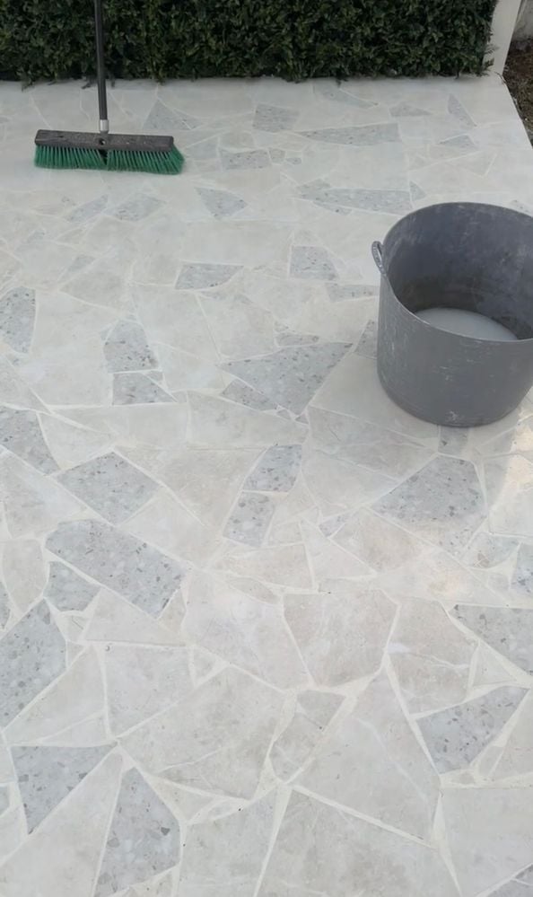

I got some cheap outdoor tiles and smashed them all up into pieces, and glued them to the slab to create a crazy pave area - then grouted and sealed.

Added a bench swing and some pot plants. Then added round stepping stones in two sizes from Bunnings to make a pathway leading up to the area.
