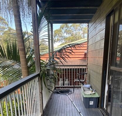

One end of our deck is rotting and we plan on replacing the timber. After we paint, is there anything we can apply to make it weatherproof? The deck is undercover but the rain enters from the side.

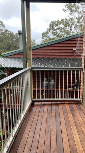

Just an update, I prepped and clean using the Cabot products you mentioned. For the oil, I used Feast Watson Traditional Timber Oil in natural. I love the finish. I ended up putting 3 coats. As you can see, the deck gets quite wet on that end after it rains.

The repair looks fantastic and its great that you've used Merbau as a replacement set. They appear to be pre-oiled decking panels, and you'll need to season them before you paint them with anything. Seasoning means that you'll need to let the timber naturally age which takes about 8 to 12 weeks depending on the weather. When the oil and tannins have leached out of the timber panel you will see a change in the timbers finish which is an indicator that you can then paint or stain the decking panel.
However, there is a way to paint earlier and that is to use Cabot's 2L New Timber Prep - 2L in combination with Cabot's 1L Deck Clean - 1L. It is designed to remove tannins and oils from bare new timber surfaces to allow for immediate coating. New Timber Prep skips the recommended timber weathering period of 4-6 weeks for new timber.

We had the rotting timber replaced with merbau and installed a new timber post on the left corner. We’re happy with the merbau colour. Could you kindly outline steps and products to use to coat / seal the deck. I’m unsure what prep work is required.

Here is the link to the shade cloth - Pillar 1.8 x 10m Surfmist 90% UV Waterproof Shade Cloth. Yes, the shade cloth is waterproof. The shade cloth can be attached using Crescent 200 x 4.6mm Outdoor Cable Ties - Pack of 25. My best advice is to fold the cut edges and secure them with zip ties to prevent the edge from fraying.
Hello, could you please send a link to the cream coloured shade cloth. Also is it waterproof and what's the best way to attach the shade cloth to this end of the balcony?

To add weather protection to your deck, I suggest covering the balustrade with Pillar 1.8 x 10m Monument 90% UV Waterproof Shade Cloth. This will prevent rain from reaching the surface of the deck and will also protect it from direct sunlight exposure. The shade cloth also comes in a light cream colour.
