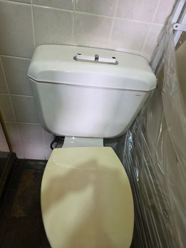

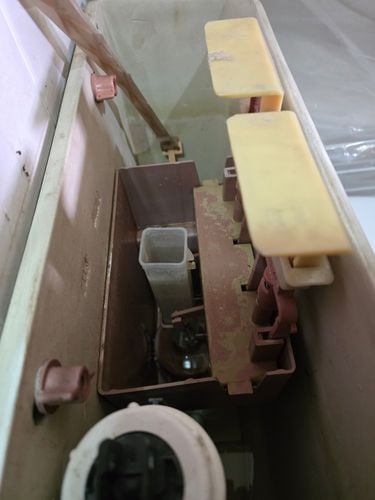

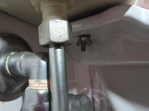

I've got this old Caroma toilet flush and recently it is leaking ie i can see water dripping into the flushing hole throught the central square section. i guess i need to replace the seating washer or seal? i manage to detach the arms but i could not get the whole square section out. think the whole thing is 1 piece. i am also unable to get the section with the flush levers out to have more space to work with. i also check the external back bottom, the cistern is fasten onto the toilet seat with 2 wing nuts is not flush pipe nut.
any ideas how i can fix the leaky thing? thanks.
