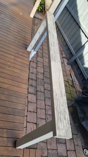

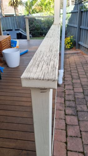

I have weathered and thin cracks on my timber railings on my patio and I want to restore and paint it.
See the photos of the cracks but I don't think paint alone will cover and protect the wood for the future. What should I do as prep work and to fix it?
I was thinking of scraping off most of the paint, using a belt sander for the majority of the work, Then I was unsure if I need a project to fill the fine cracks?
Furthermore there is a soft spot of wood near a knot in the wood which I plan to dig it out to ensure I have good wood, use wood hardner to treat the interface and fill the cavity with builders bog. I think I have this part covered as I've done this before elsewhere.
