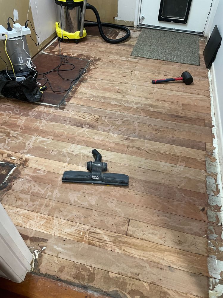

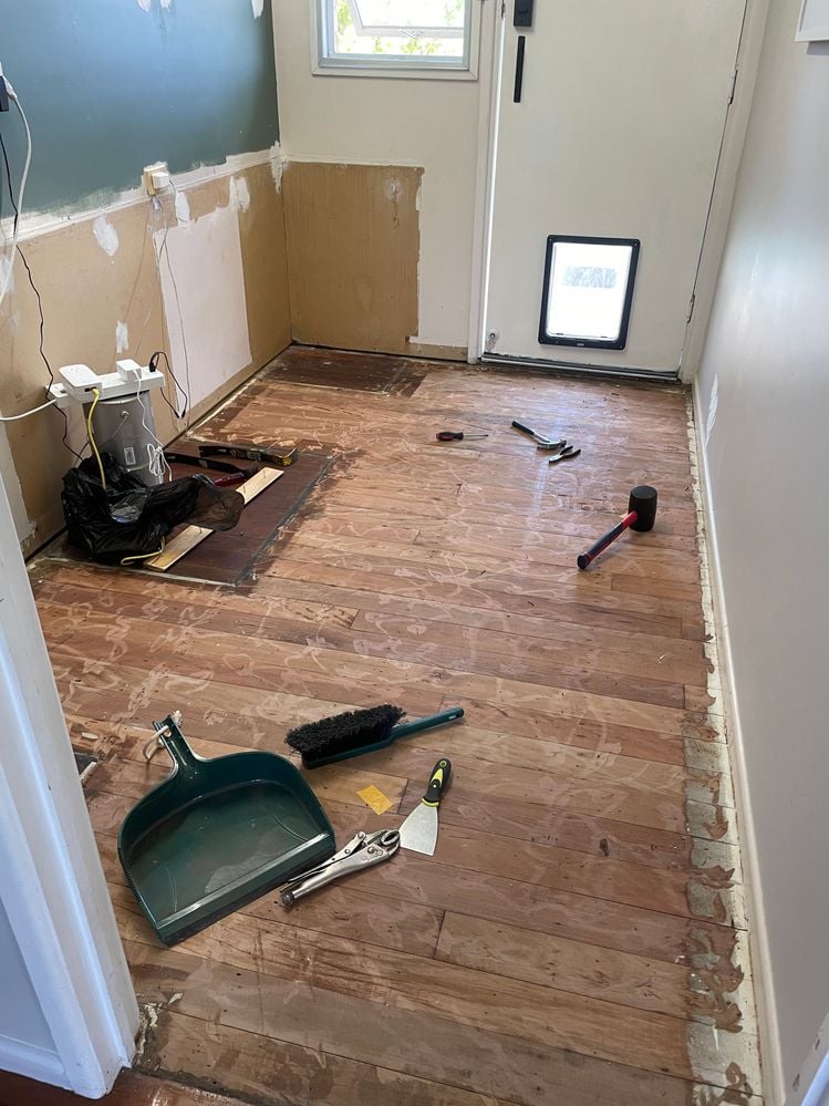

Need some help and advice. I have ripped up the very old cork tiles that were in this old laundry area. After several hours of removing all the staples and nails yesterday I am left with a semi decent condition floor which i want to restore given the floor beyond this area is the same timber and varnished.
My question, when should I fill the holes. Should I:
Sand back the whole area, retain the sawdust and then fill the holes with PVA glue and a mix of that sawdust, dry, sand down them areas softly and then stain and treat the whole floor, or
Sands everything, coat the floor and then colour match the floors with a standard colour wood filler.
Also this is a stadard harwood floor in a Queensland 1980s house. The floors elsewhere were recoated about 20 years ago and held up beautifully. The owners advise they use a hardener.
I have both cabots hardener, and I will buy the the cabots, gloss oil as given the rest of the floor was done that long ago I am guessing it was oil based.

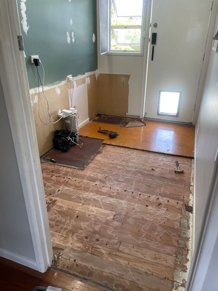

Another dumb question, have they stained this floor or is it just the colour coming through once oiled and if stained any ideas on colour - for standard finish in old houses. The tone is reddy brown rest of floors. See door frame at photos showing rest of floor
Thoughts, I did youtube this and a quick google but couldn't get a definitive answer on this. The holes are mostly small, except for the odd nail. Please help.
