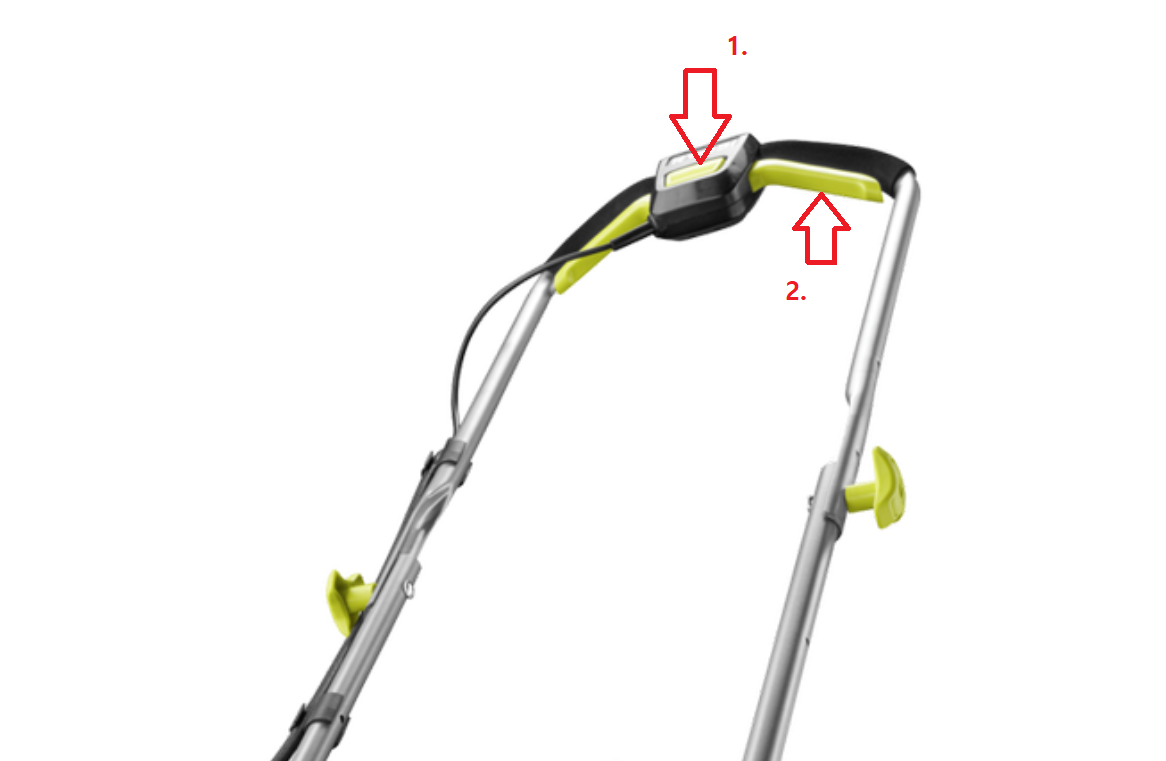

Jacob touched on it @jgood, and it's unlikely the cause as you've had it started once, but you are pressing the power button down and holding it whilst pulling the start lever?Mitchell
Good try Mitchell, but nogo this time.
