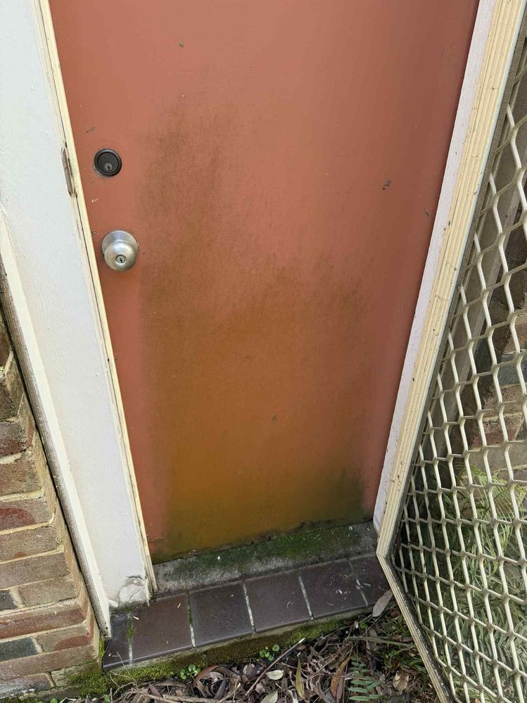

I'm looking at deleting this external door and replacing with weatherboard to match the house and a window.

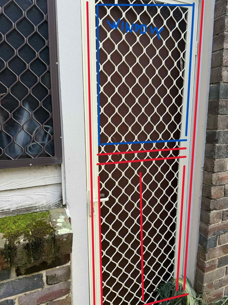

My plan of attack currently is to remove the door and frame out the void as per the mark-up. I'll be using a damp proof membrane under the bottom plate like (https://www.bunnings.com.au/cagroup-0-3-x-300mm-x-10m-standard-aldamp-dampcourse_p1060354), and fixing the bottom plate to the concrete foundation with some anchors and the side studs to the existing frame and cladding with some James Hardie weatherboard (https://www.bunnings.com.au/james-hardie-4200-x-180-x-16mm-linea-weatherboard_p0710203).
Where I get a bit lost is what other products/steps should I be installing here for the wall.
Do I need a vapor membrane/insulation?
Where the weatherboard meets the brick, do I need to add some sort of flashing? None of the James Hardie installation guides show installing in this type of job.
What else am I missing??
