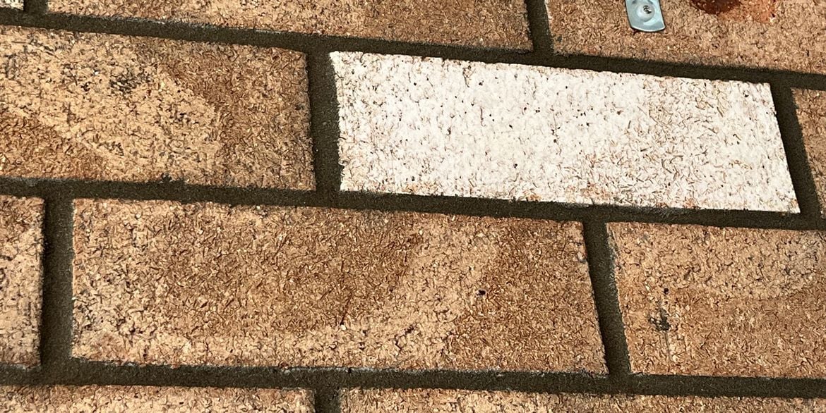

This is what our house looked like before lime washing, with a picture of the bricks close up as well.

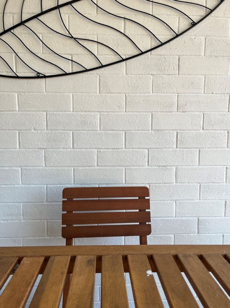

One coat of limewash result after drying one day. Each coat should dry at least a week to see what colour depth is reached.
Step 3

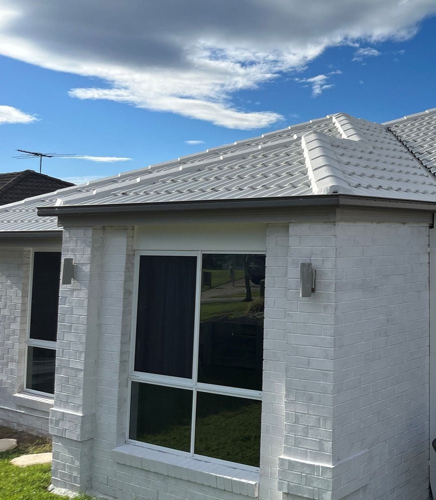

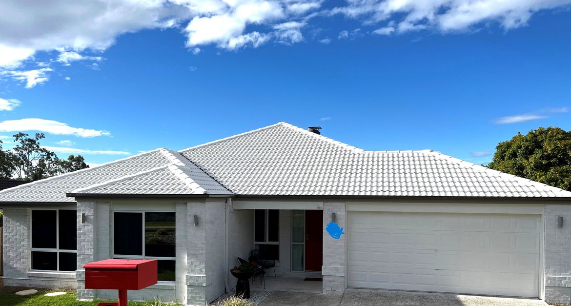

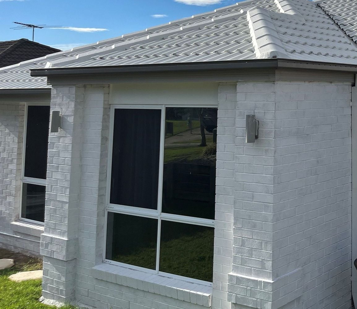

Two coats same consistency. So far we have applied just the two coats. It returns slightly transparent when it rains or is humid so we may do another thicker coat or render over it when we have funds, but we're overall very happy with the result. These photos were taken after a recent downpour hitting the front, showing the look when wet.
Step 4

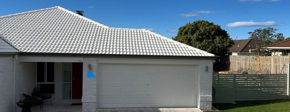

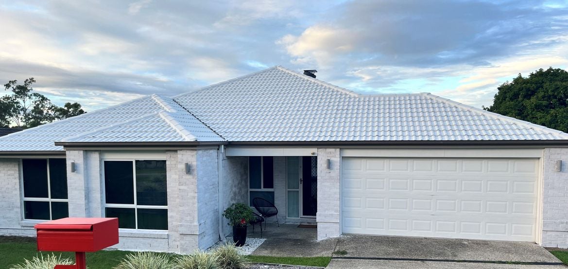

Below photos taken same day where rain didn't hit.
