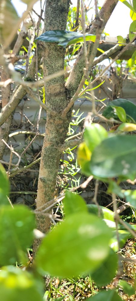

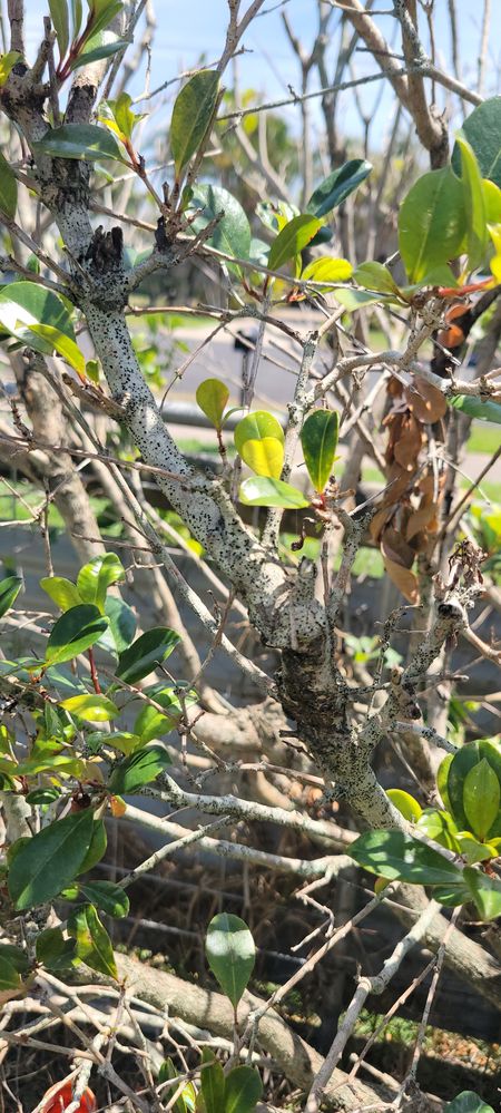

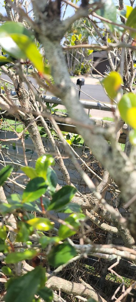

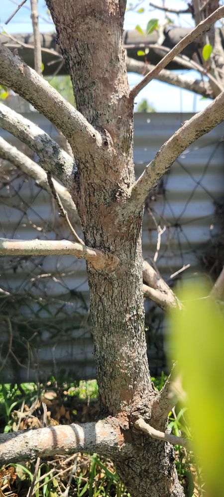

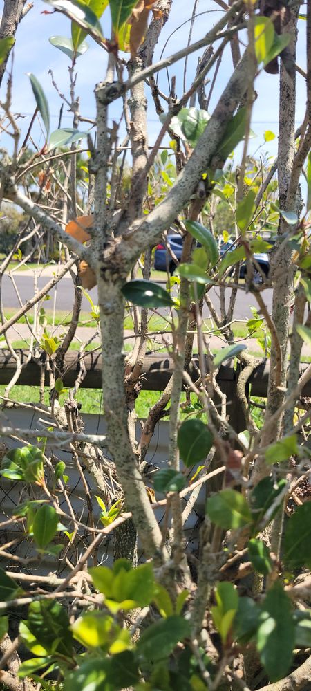

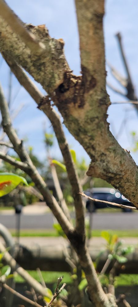

I have a sick Lilli pilli. It's dropping leaves and new growth goes brown and dies.theres a white substance covering the stems and trunk with black spots on it.
Any help greatly appreciated.

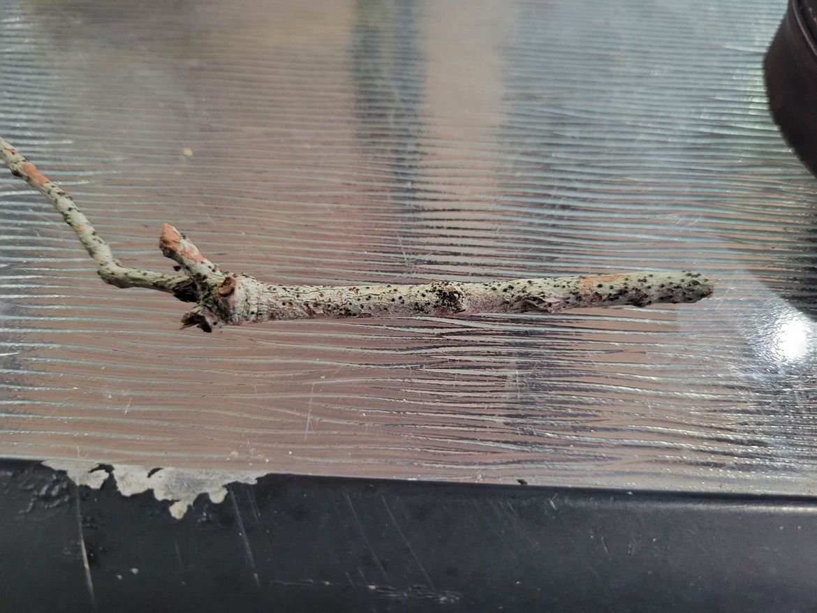

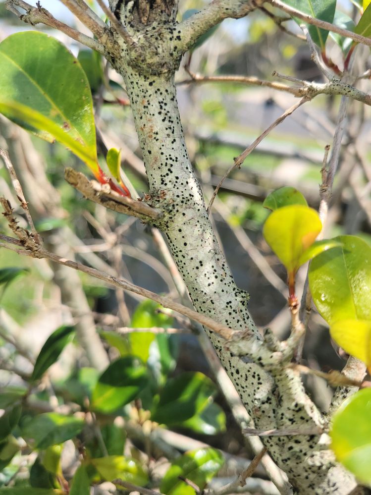

Hi Jacob,
I've had another look and the black spots are raised but hard not sticky, and the spots and white stuff scrapes away easily. The stems are green underneath.
I do live in a swampy environment but all other trees in my headge are unaffected.
I do have banana stalks on the ground as mulch but will remove and clear around the bases of the tree.
So far I have treated with fortune 500 followed by copper oxychloride and then white oil. And will re dose today and tomorrow.

Hi @johnwarner,
Thank you for sending those photos through.
I'm not 100% certain what the issue is, but it looks like it could be either insect-related or a fungal issue.
If you run your hand over the black spots on the trunk, do they feel raised or sticky?
It looks like they could be caused by a scale insect. If you grab a knife or thin-bladed tool and scrape over the black bumps, do they come off?
What is the soil like? Is there a lot of leaf matter built up around the trunk? Does it look like it is constantly sodden?
I think we'll have to do a little bit more investigating to be sure of the cause and propose solutions.
Allow me to tag our knowledgeable gardeners @Noelle and @robchin to see what they think your lilly pillies are dealing with.
I will assist further when you can get back to us.
It sounds like you could have a scale issue, which can likely be treated with this Yates Ready To Use Scale Gun Insect Pest Killer, but seeing the lilly pillies would certainly help to confirm this.
