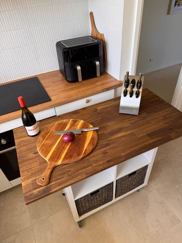

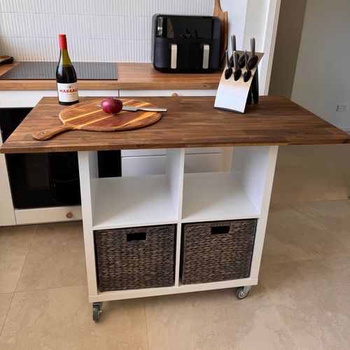

We needed more kitchen space to cook together without getting on top Of each other.
After researching, we decided a mobile kitchen island on wheels (instead of a fixed one) was the way to go. This trolley has added workspace and solved our space issues, making cooking together much easier.

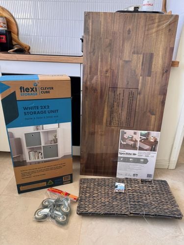

Materials
2583385 CUBE UNIT FLEXI STORAGE
76X39X76CM 2X2 WHITE^
0446778 ACACIA PANEL BROWN MULTI USE
1200X600X18MM^
0285881 CUBE INSERT NATURAL FLEXI
32X35X32CM DARK HYACINTH^
3940383 CASTOR SWIVEL BRAKE MOVEIT
75MM PVC GREY 4PK 15790
Tools
Impact driver (drill) with Philips head attachment.
Steps
Step 1
Headed to our local Bunnings to grab everything we needed.
1 x Flexi Storage Cube 2x2
1 x Spectite Timber Panel 1200 x 600 x 19mm
2 x Flexi Stirage Cube Inserts
1 x 75mm PVC Castors 4pk
all for $150

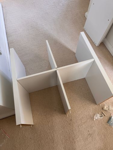

Built the Flexi Cube as per instructions

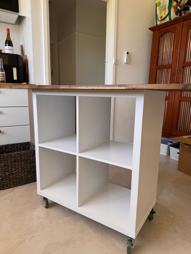

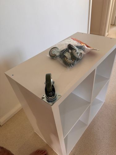

Added castors to the cube using 8G x 22mm timber screws (I had these left over from previous projects
Step 4

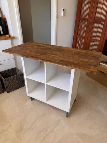

I flipped the cube over on to the wheels locking them to stop it from moving.
I then placed the timber panel on top of the cube and measured around to ensure it was in the middle.
I then used no more nails to glue it down (I also had this left over from a previous project)
