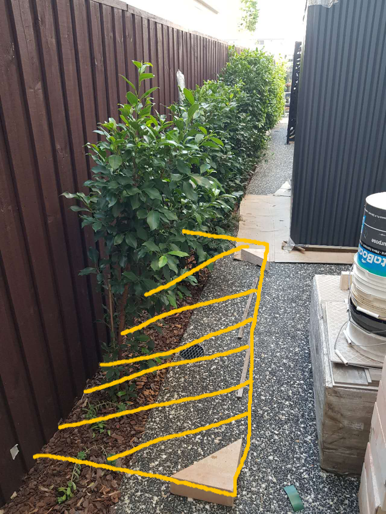

Im planning to position my shed to the yellow area indicated in the image.
The exposed aggregate concrete path has a slope towards timber fence.
Will remove the plants in the area and pour a concrete pad that is levelled to the path edge. Then lay a levelled paver floor for my shed to sit on (Shed 80cm deep x 200cm long, Paver 40cmx40)
What I am concerned about atm is the concrete pad might sink over time due to the ground underneath settling. Cannot fit a compactor in where the concrete pad is going to be - too narrow.
What can I do in order to avoid this potential problem prior to pouring?
Also is it a good idea to have a levelled paver floor sitting on the exposed aggregate concrete path and concrete pad? or is there a better preactice? And any other things I need to pay attention too?
