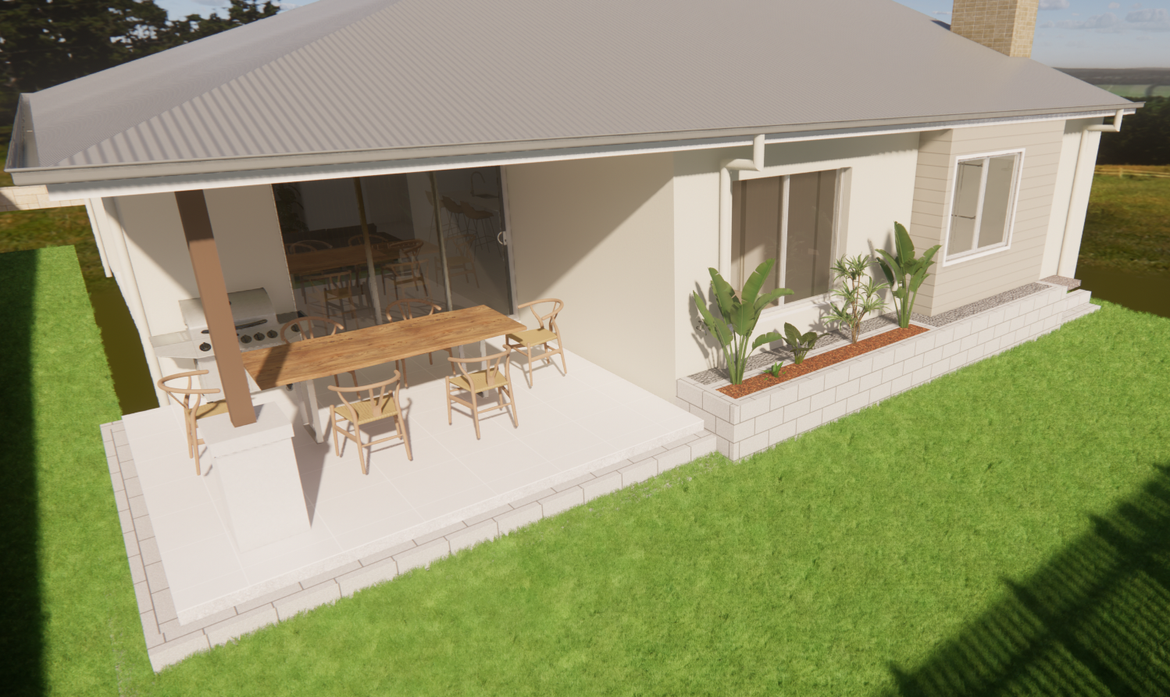

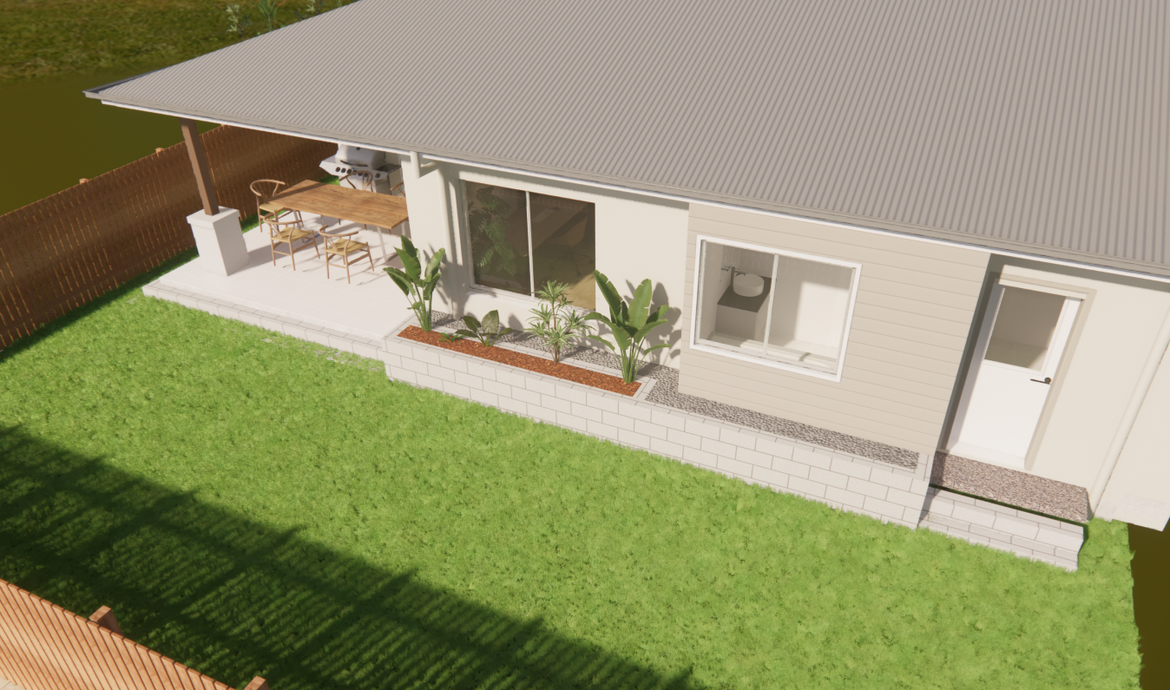

I am currently trying to achieve a flatter gradient in the backyard, and my only solution is to create a "raised" block garden bed near the house, which will go down past the house slab level, allowing the turf to be lowered.
I have done some reading and am aware of the drainage & termite barriers required, I'm just having trouble grasping exactly what needs to be done.

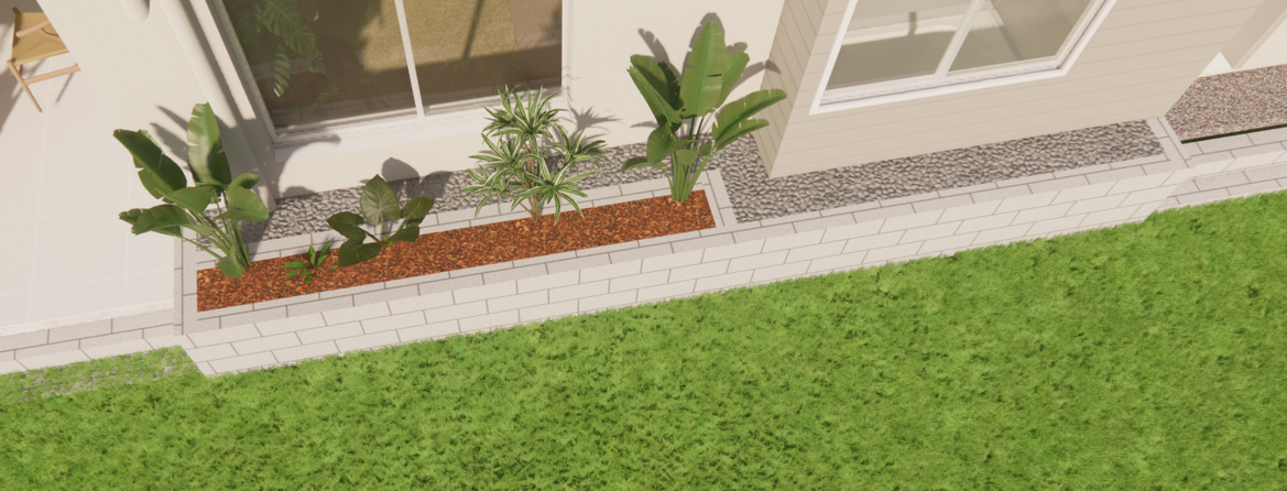

I am envisioning a 100-300mm gap off the house with an agi-pipe and loose gravel filled to the top, followed by the block garden bed, approximately 800mm high. This will allow the house weepholes to drain, but I am not sure how to connect the drainage from the garden bed to the agi-pipe?
There is a downpipe located in this area, which could help connect the pipe to the stormwater line I think
Will I need to tie the blocks into my house slab, as that area is on uncompacted fill and slopes away from the house?
Is compacted gravel or strip footing best for the blocks?
I also have Newport cladding in a portion of it, which I was going to waterproof & leave as gravel to avoid moisture & rot.
We also have a timber frame for reference, so I am trying to be verrrry cautious.
(The house is currently under construction)
