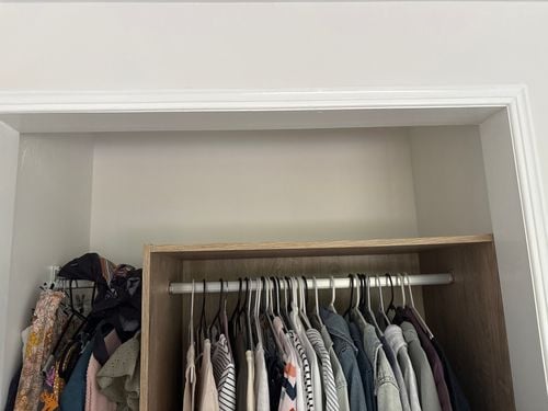

I am wanting to build 2 shelves that Bunnings will need to cut to size for me. I am wondering what timber/plywood to use. The first one needs to be 1095x470mm and will it on top of a wardrobe and extend to the wall. It will therefore have support both sides and near the centre where it will touch the top of the wardrobe. I have attached a photo.
The second shelf I will mount on brackets in my laundry area, above my dryer (heat pump) and needs to be about 790 x 350. I am happy to paint the wardrobe one but the one in the laundry I want the warmth of timber (coastal vibe).
