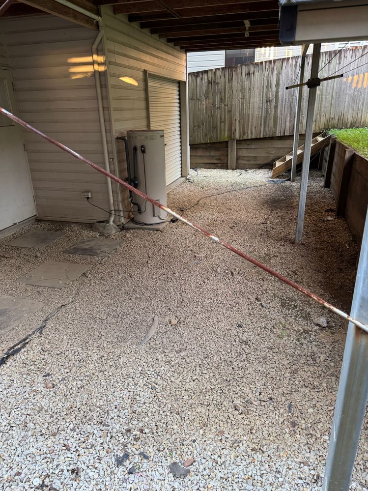

I am very much a newbie when it comes to DIY - we only bought our first house in June!.
We have a raised QLD house, all legal height, and underneath the house at the pack is a gravel/soil area.

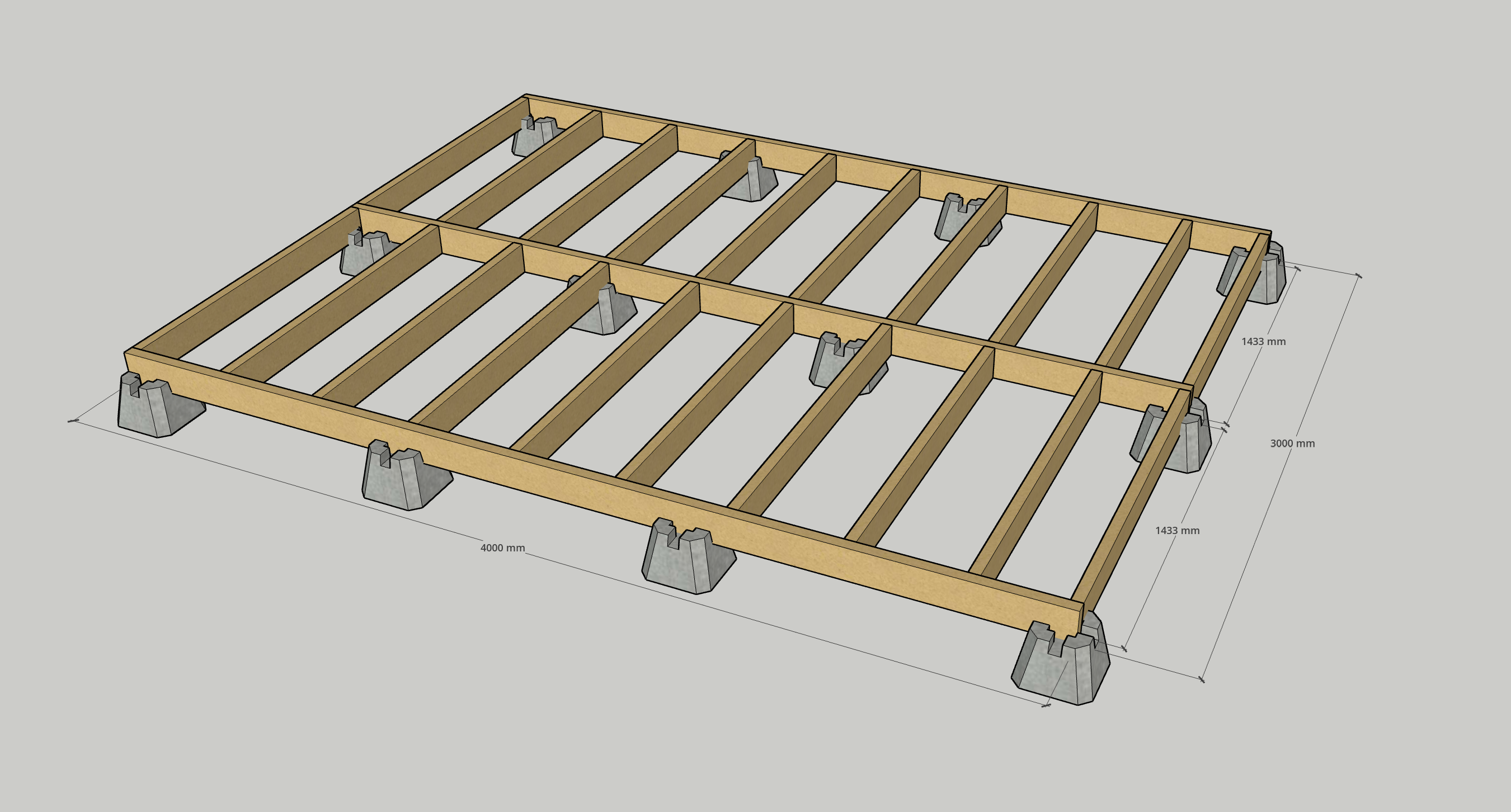

I am contemplating building a low level deck under the area so that we can walk out there comfortably, and also have an inflatable hot tub & ice bath out there.
Due to the cost, I plan to build it in multiple stages - starting with a 4m by 3m area for the icebath, then following by a 3m x 3m area for the inflatable hot tub, ideally linking the two areas with a small walkway.
I am thinking using the TuffBlocks for the foundation, mainly because they will be on soil, and I plan to add some road base and compact it under each TuffBlock.
I think i would need 2 bearers and 11 joists (including the 2 ends) equally spaced, and I am thinking of using 140 x 45mm timber for the bearers & Joists.
Some questions:
Do i need an additional bearer down the middle, or is a 3m joist span acceptable for a low level deck, given it may have an inflatable hot tub on it?
If i have a bearer down the middle, do i then split the joists into 2 x 1.5m, or do they have to lie on top of the 3 bearers, adding unwanted height?
Does every joist need TuffBlock under them, and so that would mean 3 TuffBlocks per joist... ie: 33 TuffBlocks!??
Do the bearers also need TuffBlocks or do they just sit under the joists?
Trying to keep costs down, and keep it simple, as this is my first decent DIY project.
Any advice welcome before i go too far...
