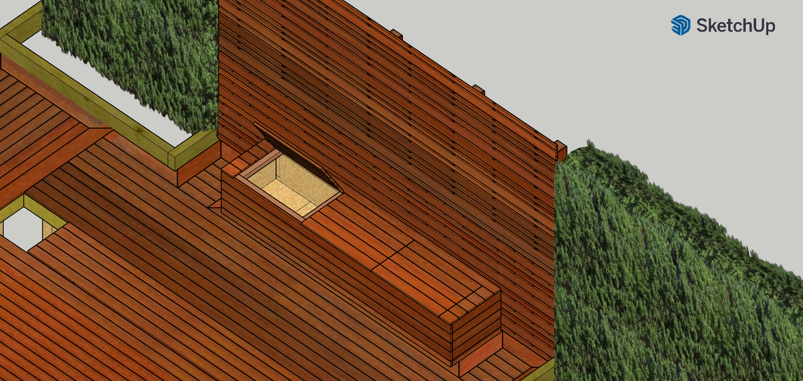

the design shows the alfresco and the house, and all the completed decking, with seat and privacy screen from a few different angles and how i intend to use it as storage, with 3 panels on hinges.

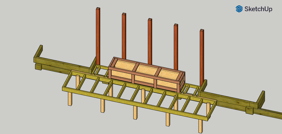

The following shows each part of the project, and the intended frame design. the privacy screen will be the specrite screen panels x4 as seen in this image from bunnings:
https://www.bunnings.com.au/specrite-1800-x-902mm-pre-oiled-merbau-alternating-slat-fence-panel_p8500281
this will save me some time and cost along the way
the deck supports will be 100x100 H4 treated pine,
deck frame will be 140x45 treated pine and merbau decking, with merbau seat.
the screen will be supported by 100x100 cypress posts (DAR) which I'll stain with merbau stain and the seat/storage box will be 90x45 treated pine lined with plywood for the inside to stop any spiders and protect the storage contents from the elements.
