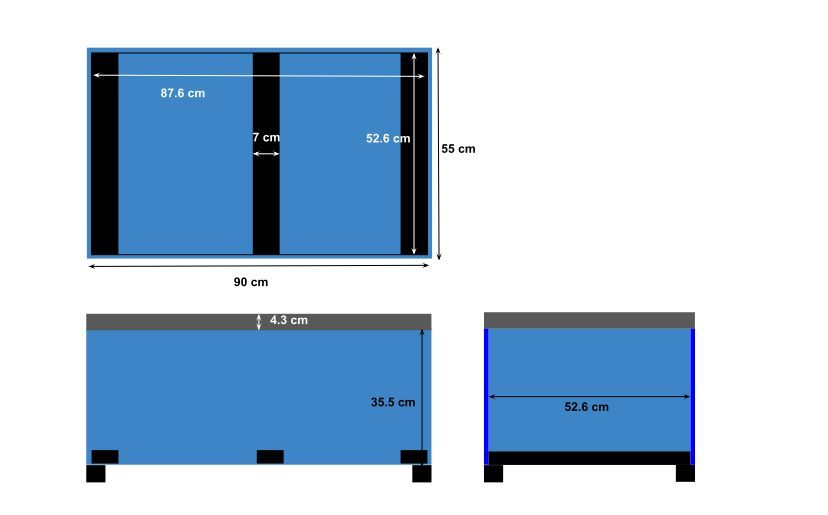

Plan Plan Plan. You should calculate all lengths, where what will land, how it will look in front, back and side
I even planned how many cuts to make on the large board.

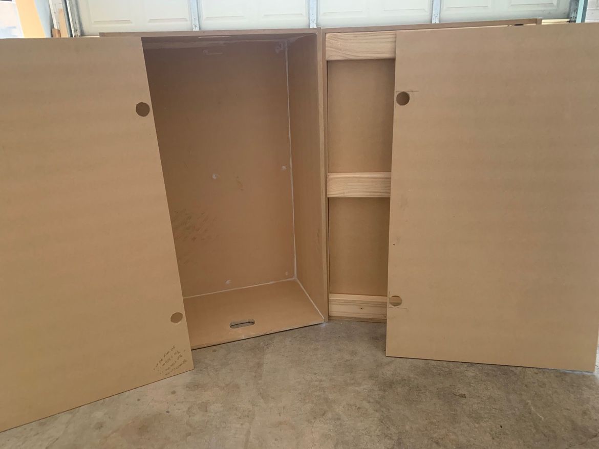

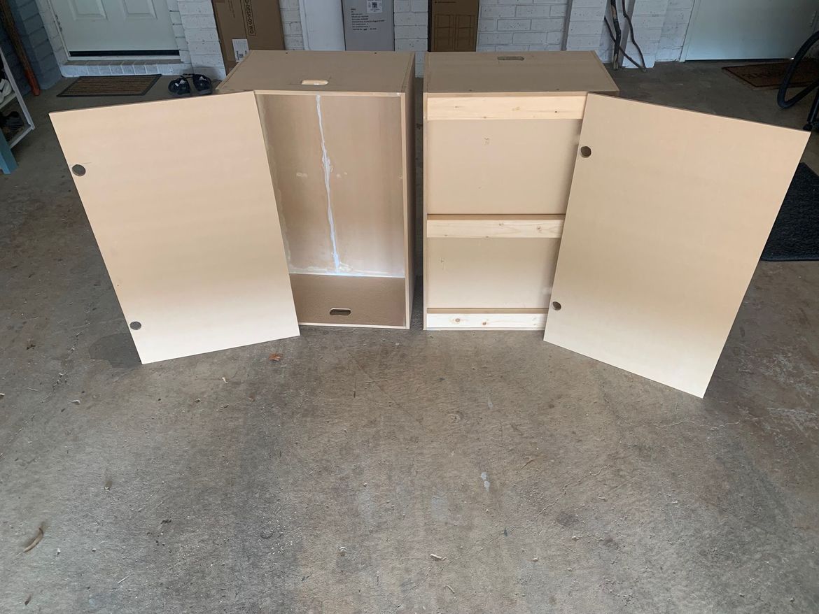

Start by assembling the box. Put three framig timber on the bottom for structural integrity. 2 people can comfortably sit on this ottoman. Drill holes for hinges in the top peice.

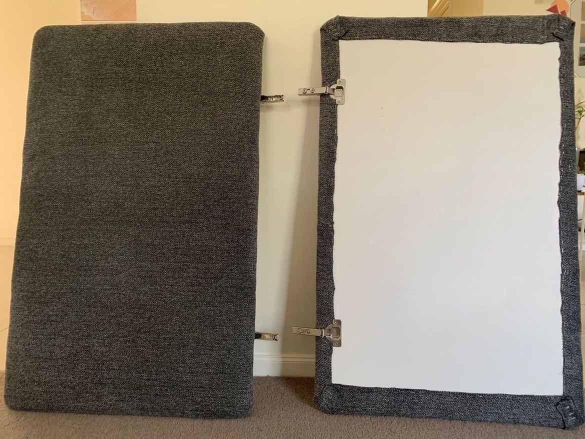

Paint the inside. You can choose to cover it with fabric as well. Put foam, polyester fill (to get a smooth finish) and cloth. Start stapling. There are several videos in you tube on how to get a smooth finish. Install hinges

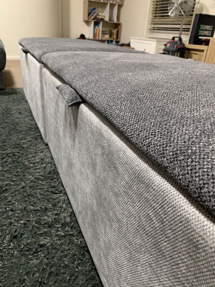

I sewed the sides to create a sleeve. Inserted the sleeve into the box. Took some elbow grease to get a tight fit. Staple top and bottom. Using same fabric, stitched a small handle and stapled it as well. Added gas struts for easy opening and closing.
