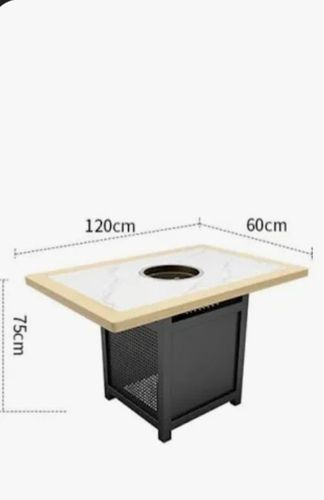

Something similar to this

Thanks for sharing the image. What you’re showing is a purpose-built Korean barbecue or hotpot table, and these are proprietary products made by manufacturers. They go through extensive testing and compliance checks regarding the materials used for the benchtop and the installation of the gas burner. The burner itself is specifically designed for that purpose and isn’t something that’s available in our range.
For a D.I.Y. version, there are too many safety considerations. Insetting a gas burner into a table involves careful design to ensure the surrounding materials aren’t affected by heat, proper ventilation is maintained, and the burner is safely contained. Those tables usually have a metal drop-in bucket to contain the heat from the burner, along with other proprietary parts. Because of all these factors, it’s not something that can be safely replicated as a D.I.Y. project. I’ve never seen anyone build one from scratch safely, so I’m not able to provide guidance on cutting out a table to achieve this.
My advice would be to purchase a purpose-built unit that suits your needs rather than attempting to build one yourself. It will be much safer and ensure the table performs as expected.
