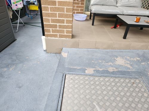

I have a backyard with concrete next to the tiles. The concrete has slope making it not usable enough.
I wish to put a composite deck with aluminium subframe on it to level it to the tiles. Photos shared.
Well the tiles and concrete has only 27mm difference in height at one side.
I am wondering if I can build a deck with height of 27mm on one side and around 320mm on the other side.
I know minimum recommended height is 50mm but is it ok to screw the composite boards directly to the concrete with some thin bushes below them to allow water drainage?
